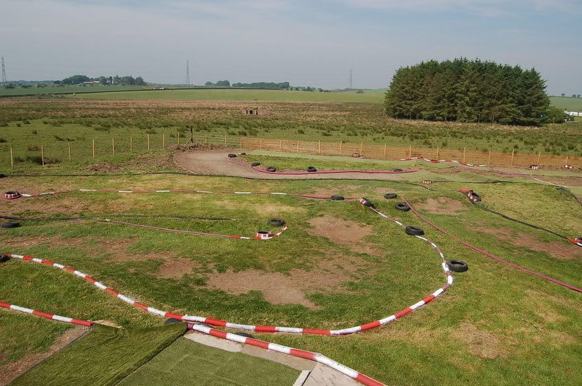

I find mulchers not that great, of all my tyres, mashers are pretty good, only slightly bettered by the stock maxx tyres. Here is the track.

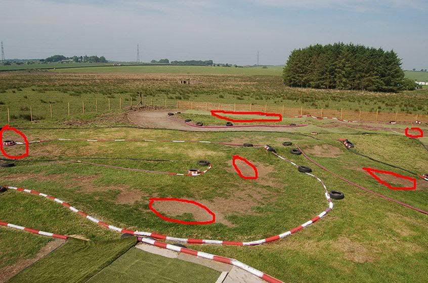

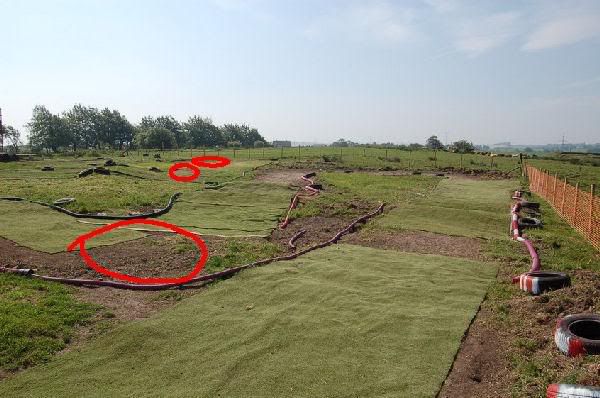

Here are the bad areas for wheelspin:
Mostly the mud/loose parts of the track, but I do get it on the grass and occasionaly on the astro.

Just an idea here, especially since I don't know your track particularly, but you could also try a different like. It appears as though your having trouble were the typical line is. Try something like the line in purple. The black appears to be the usual line people run. However, if you carry more speed into that first turn in the picture and go wide then on the inside, you might have an edge since you would have more traction and be able to carry more speed.

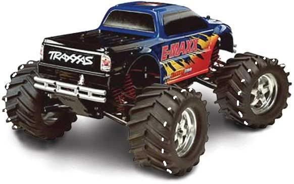

CCristo - I was considering cutting lines in the edges of the tyres like this:
I'm not sure if that would help alot, maybe cutting the lines further in?
