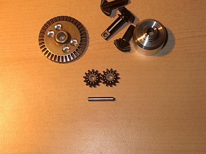

Looking at the pin itself only one end is tapered... the other end is flat.
Both the Diffs come with the pin with only one end filed.
Looking at this pic you can barely see how one end is tapered...... I'll taper the other end tomorrow.
Thanks

03.10.2007, 03:13 AM
Hi NIS! welcome to the forum.
These Quads with paddle tires do nice in the sand..
I understand your newbe feeling, you don't expect this to be like this when you buy something new as a set.
I guess something went wrong with your diffs; here is what you should do;
Take a dremel and make round corners on each end of the pin.
The first batch of these diffcups had the same issues, the pins should be tapered on both sides.
DOn't take of too much, you want the pin to touch as much aluminum as possible. Just take off enough so you don't need to force them in. (the pin needs to move freely to prevent wear on the gears)

03.10.2007, 04:51 PM
Thanks.
No diff problems yet.... only reason I got these is because I'm building a BB Tmaxx.
I rounded the non tapered end..... now it's perfect (nice and snug).
