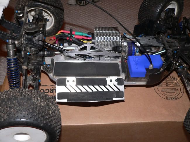

Glance at this CRT conversion pic and you will see I spent considerable time planning out my dream conversion. I chose the CRT at the time soley for two reasons.......at the time Mike suggested it, and I was able to find more parts more easily, including my local track. Bout the same time I finished it, the 8T released and Mike wnt off and converted the Losi 8T rather than a CRT (well, it is his job to be familiar with all trucks after all). I spent so much time on the computer planning and calculating the best layout that I can now look at any truck and picture in my head wether or not it would be optimum for a conversion.

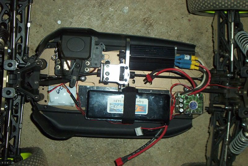

And at this point, I still would have gone with the CRT. But only because I wasn't worried with obstacles lilke keeping existing locations of the center diff, braces, servo's. I also wanted a single battery layout. I suspect you would preffer a more straight forward conversion. Given this assumption, I think the 8t is the best candidate (Mike's 8T conversion pictured below). The offset center diff and gearcase diffs already allow you to mount a single battery closer to the centerline of the chassis without having to relocate everything and create a need for more custom parts like the drive shafts (the dominoe effect WILL enter the project somewhere. I call it "scope creep"). A closer to center mounting of the pack gives better handling, generally. However, I feel the CRT is a bit tougher.
If you want to go with high voltage/high capacity batteries and long runtimes (which means more battery weight), I think the split battery (side by side mounting) is more convenient and the only way to get left to right balance on the chassis.
For a split battery option, I'd prefer the CRT as it has a bit more of a canvas to work on.
Sorry, could babble on about this one. I'm sure there's other valid pro's and con's for either one. Just my opinion.

Your CRT conversion looks great!

Cadima, very nice looking conversion. Any chance for some more pics from different angles. And maybe a short description of what you did/modified.

The thing I REALLY like is that integrated CD and slipper!

CADIMA
When is your slipper diff going to be avalible ?.
