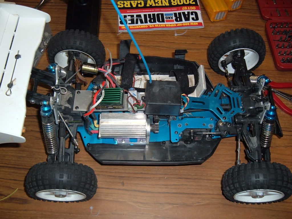

I recently sent Griffinru a MM and had him do his "stage 1" mods to it. Upon receiving it from him I had a good look at it. His workmanship is very nice and clean, all mods are stock appearing and well executed. Basically the intent of the mods is to keep the esc cooler and help it to handle higher voltage. My first tests are with 4s lipo, I will try 5s lipo as well.
Test vehicle is an OFNA MBX R2
http://www2.towerhobbies.com/cgi-bin...?&I=LXAXV2&P=7
The buggy has a feigao 7xl, RCM heatsink/clamp, 15/51 gearing, and 50k traxxas diff fluid in the center diff to assist in motor braking. I am running a UBEC(of course) and have the MM bec disabled. My testing are is blacktop, cement, cut grass and dirt. I ran it for 10mins and then used an IR temp gun to determine the temp of the batteries, motor and esc.

Heres pics, cause I know you guys will ask

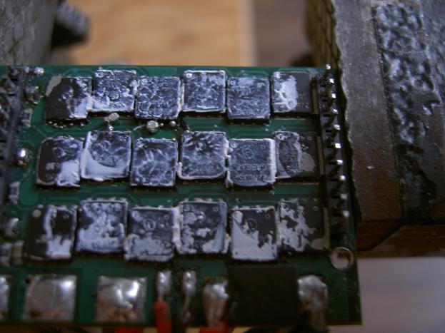

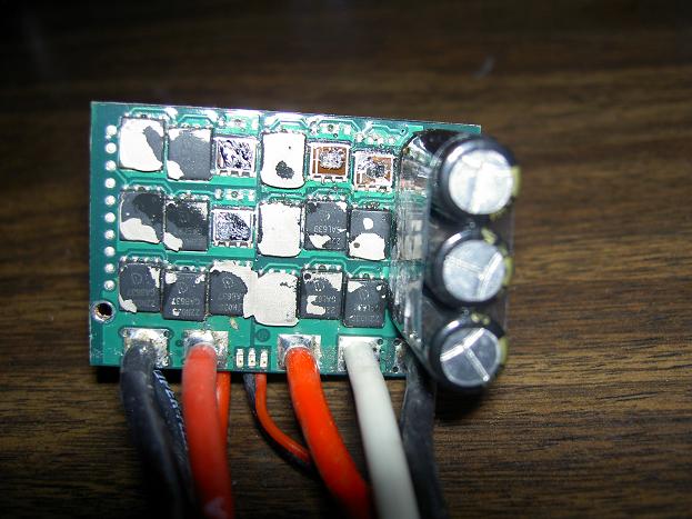

Ok tried 5s with the above setup. Yes 5s on a 7xl, I figured that I would give the MM a workout. Well it works and worked well until a small piece of steel/metal found its way into the spur and locked the pinion to it. The buggy was probally doing 40 at that moment and it stopped very quickly. The MM let out some smoke and is dead
Took it out of the buggy and had a look at it. Nothing looked obviously burned so I plugged it into the castle link. Programming worked fine so I guess that a fet crapped out, or something else let go in the power supply dept. I had the throttle pegged when it locked up. I talked to Artur and have shipped it back to him to inspect. I will post again when he gets back to me.
This really sucks cause the 5s setup was working very well. No cogging from a standstill, great low speed control, no hestitation either. I only got a minute of running, but nothing was even warm at that point. If he can fix it I will retry with 5s on a 9xl with the same gearing. That should put it at about the same speed as the 7xl/4s combo. I will also set the mesh a little looser and keep away from my shop parking lot as there is all manner of crap there.

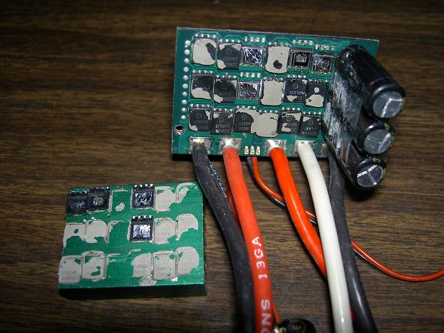

I am impressed with Mamba built-in protection!
It was a very short high current spike, which took out one phase, check the melted solder :) but didn't destroy the rest.
As for fixing I sent you e-mail with details.

Talked to Artur this morning and he will try to fix it for me. I f not he says that he might have another use for the "brain" PCB section of the MM. Should be interseting. I will be sending him another MM soon to do the stage 1 mod to. It worked so well for 4s that I may have all of my MMs that I use on 4s done. Also heard that Mike is having some 5s success with the stage 2 modded MM that Artur sent him. I am waiting eagerly for some posts from Mike
