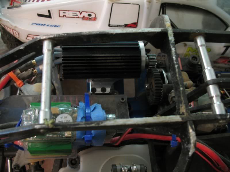

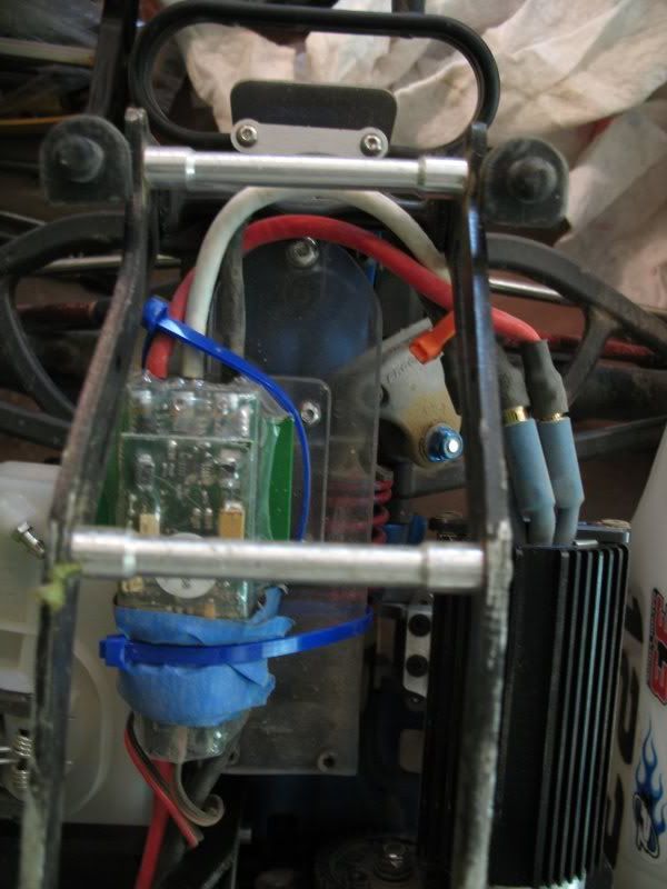

If you like the low profile look then the RC Solutions cage isn't for you. It' requires the body to be mounted higher. I wouldn't get a cage again. It's a pain to do even simple things now. It's heavy I had to repackage every thing to get it to work. Yes it's strong I can stand on it. It's just not worth it. If I was to do it over again I would use a Proline Desert rat body and glue and rivet AL washers to the post mount holes to help with pushing though.
Sorry these are a little out of focus. After a few times running it will look like this.
It's hard to tell but I was trying to show how the right side is bent from a hard landing.

I'm scared to ask why theres a fuel tank on that Revo...
09.13.2007, 08:31 PM
Two words: fuel cell.
A roll cage is nice because it helps protect the internals from a bad driver, but it sure makes working on your truck a PITA. And since the roll cage is metal and doesn't "give", and force exerted on it can potentially break whatever it is mounted to. I've had good luck with retaining the carry handle thingy - that and the Techno wing helps protect it quite well, and it light.

No not a fuel cell, we do make the plates for fuel cells at work. Too big for this guy though.
The BEC lives in the fuel tank. I was going to have it so that you open the fuel lid to plug in the battery. Just like they do on plug in cars. It's just for a bit of humor.

I was thinking rear mounted flame thrower, or turbo jet
