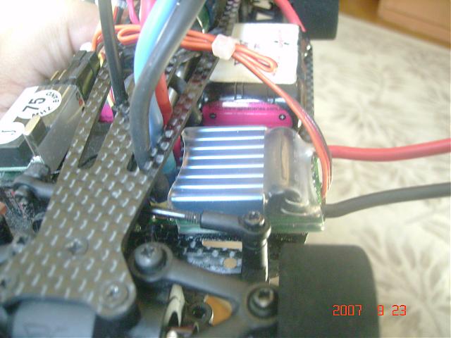

I'm not hyping the ESC. Here are some picture. I might have the diff set up right.

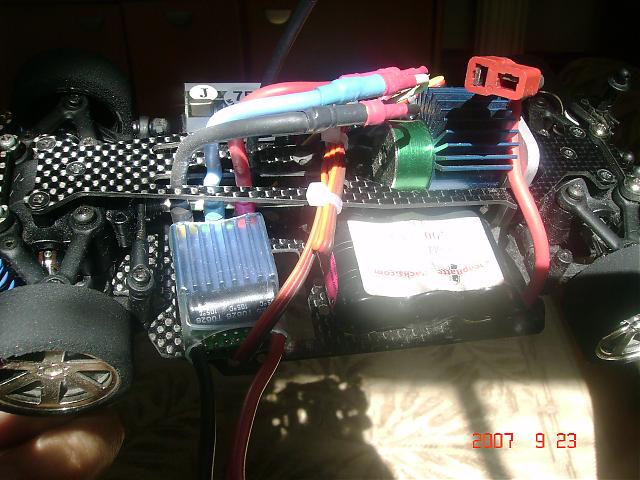

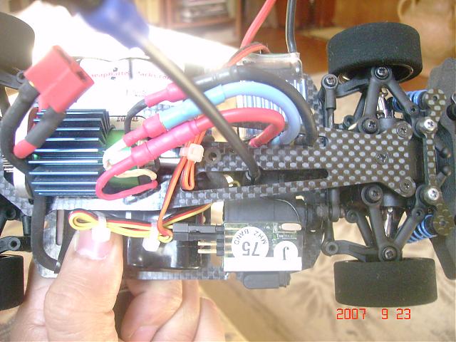

More pictures.

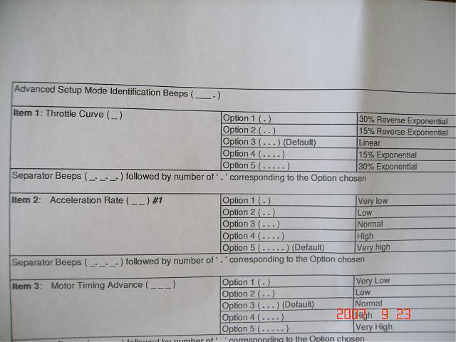

Instructions pictures.

Here are some pictures of the MLST I'll be using to test the ESC.
