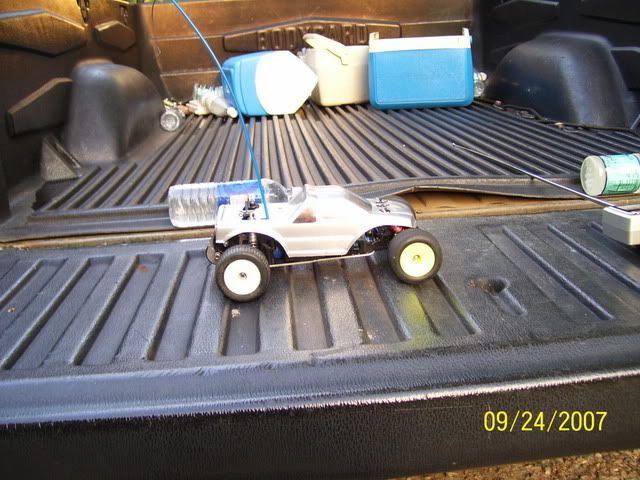

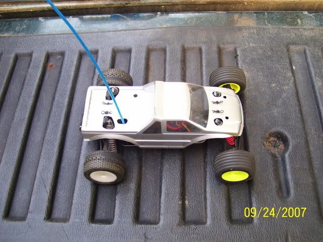

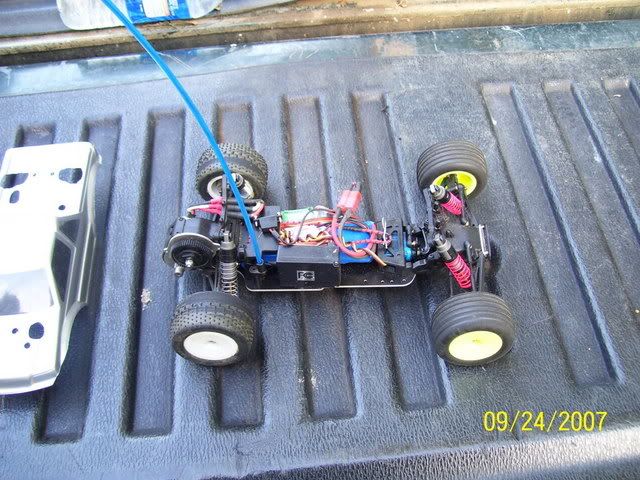

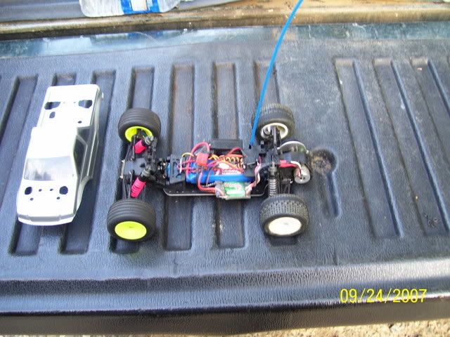

I have been thinking of this, ever since the Mini Slider was announced. I got a mini slider chassis and put it on the Mini T. all you need is the chassis and F/R bulk braces and battery strap. It will stretch the wheelbase two inches and allow you to run any RC18 pack, I'm using a Hyperion Litestorm 1800 20c 2s pack. I had to use a Mini Quake body, Because the stock one no longer fits
