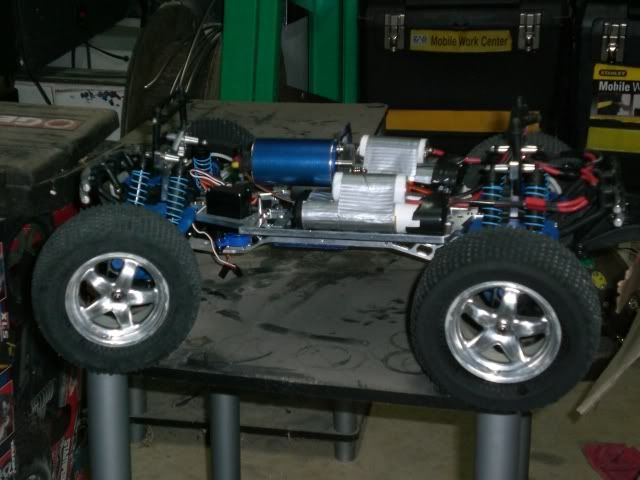

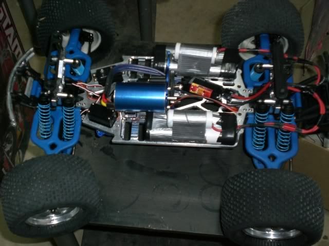

here is where it sits as of now. i'm still gathering parts for it like the steel idlers, hybrid bulks with 1/8th diffs, motor pinion(or have the shaft milled down), and a few other small items.
its running (not really yet) a bk9920 esc, kb 45mm can 1700kv motor, flm extended chassie, ffrc towers, trinity extra heavy shock springs, 3.3 axles, rpm arms, front and center aluminum skids, and 5s2p a123 batteries. its still a work in progress, but i've only had the truck for about 2months now. should be all up and running by the end of this month maybe sooner hopefully. i'll gear as closely to 40mph as i can and adjust from there.

Nice E you got there Tashpop
