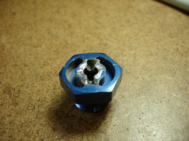

Thanks guys.... although, I think I may have found ONE problem here for the badlands wobbling.

The tire that was on that 23mm adapter wobbled considerably more than the others. Also, I seems like when I first put the tire on say tire 'X', then held that one so it wouldn't spin (to check another tire for balance), then went back to tire 'X', it would start wobbling, which leads me to believe that I 'distrurbed' the foam insert in the tire, that's the only thing I can think of.
Anyways, I checked out each 23mm hex adapter one by one (pro-line brand, btw) on the same tire, and to my discovery, most of the wobbling was because of the adapters, each one had varying degrees of wobble. One of them, has perfect alignment. I think I should go pick me up some Dace adapter then.
