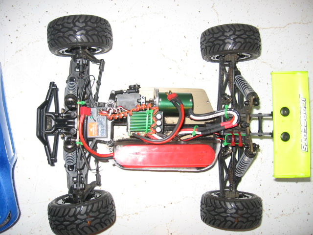

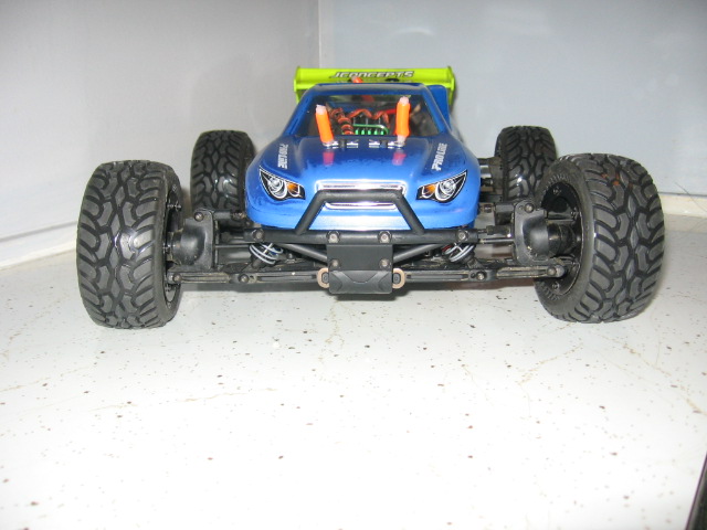

Crt .5 - 12.13.2007, 10:54 AM
The handling is amazing on the CRT. The center diff makes it driveable with big power. Worth the extra $ imo.

ilpufxit, what chassis and batt do you have mounted on there? I have a lipo that is 44mm x135mm I hoping fits. May have to rethink this if not.

Battery mount, got real lucky!! - 12.13.2007, 10:28 PM
I made the battery mount out of a piece of plexiglass, bent and screwed to the chassis. I just got back from an indoor track where I broke the mount. I was extremely lucky when the spur gear chewed on the battery leads and sprayed sparks but no lipo fire, phew!! Didn't even cook the esc, wow.
Now I'm going to make something a lot stronger. Maybe some heavier Lexan will do it. It was a stress crack across the mounting holes.
The CRT is a pretty heavy car, especially with a large lipo pack. When it crashes, it crashes hard. Nothing stock broke though, just my crappy mount.
BTW, the battery is a Neu 5000mah3s

Fin - It will fit no problem - I'm have an emaxx battery tray on its side 45 * 145 with no problems.. Maxamps 5000 3s... I screw in bottom to the chassis and top to a plate off of the centre diff..

He has the stock chassis, so thats why it looks more crammed in there Mikes chassis is long (I took a peek at my xmas present's)
