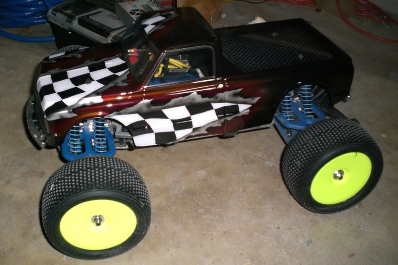

i just got some grp truggy tires for my emaxx. they are handleing the the balloning problems i was having really well, although i'm not going 70mph. here's a pick. i got them premounted on 17mm rims so you'll need to use 17mm adapters. integy makes a set and they're for sale everywhere. i think you'll get ballooning problems with pretty much any mt tire/wheel combo. you need to look into the truggy tires which are lighter, narrower, some have built in ribs, and have less sidwall to stretch out.

Truggy tires would be the way to go IMO if you are set on running something that big. They are about the same height but narrower and lighter which will help you with both speed and minimizing the load on your drivetrain.
