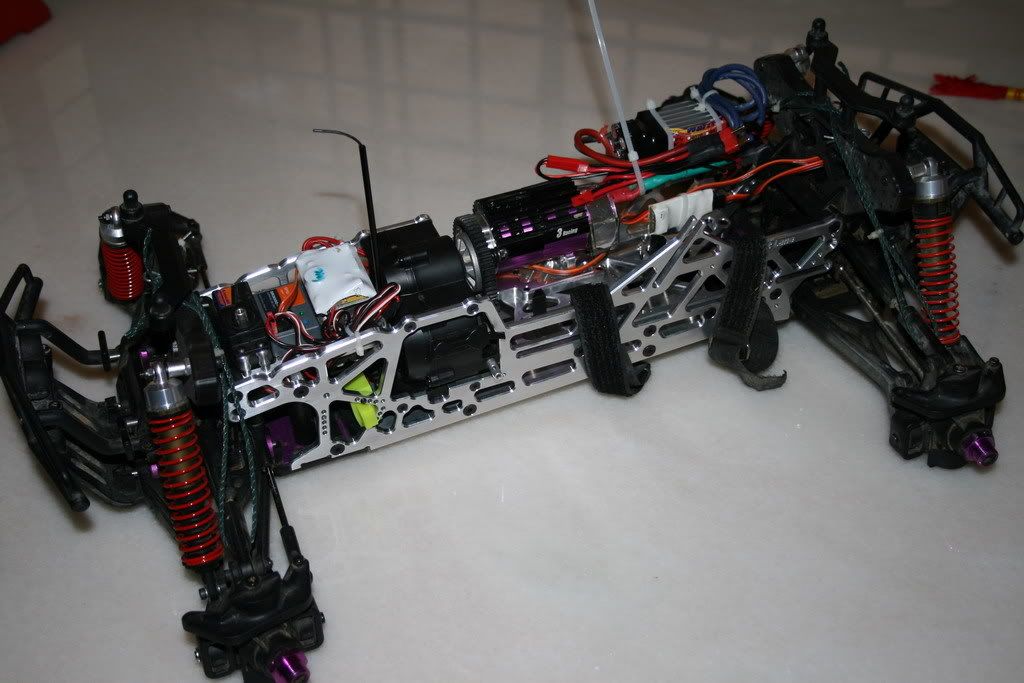

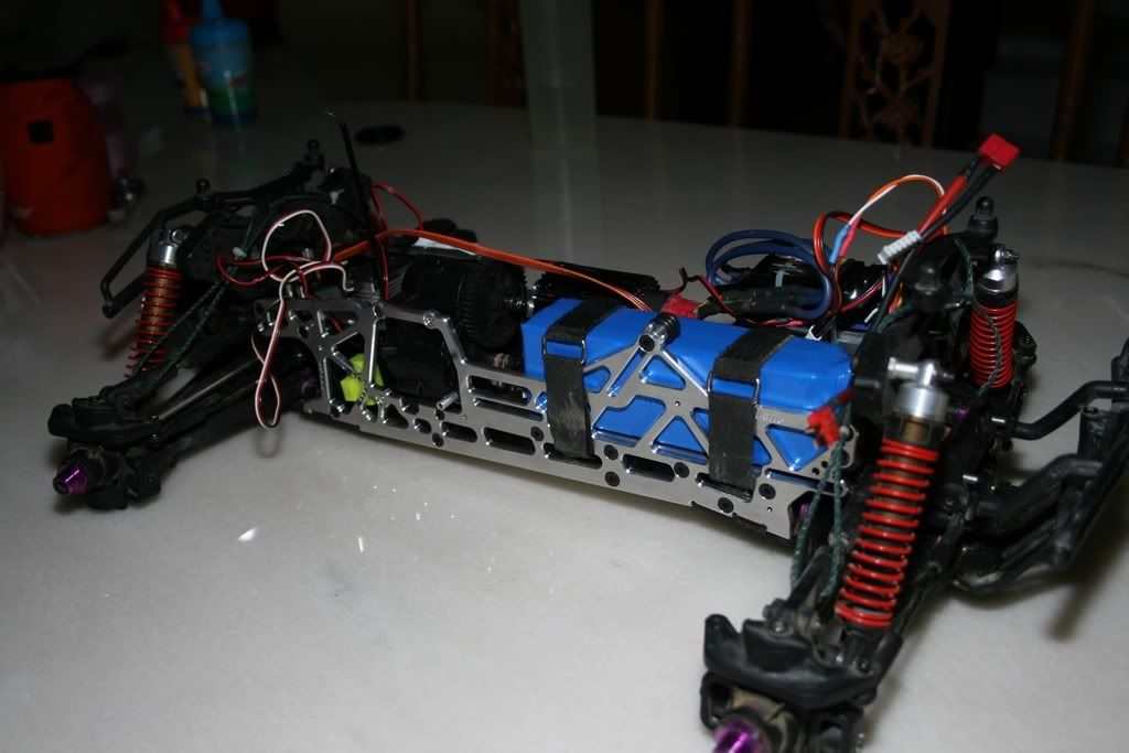

Hi guys,
I received my conversion kit from Mike a couple of days ago & started building over successive nights. Here's what I have so far :

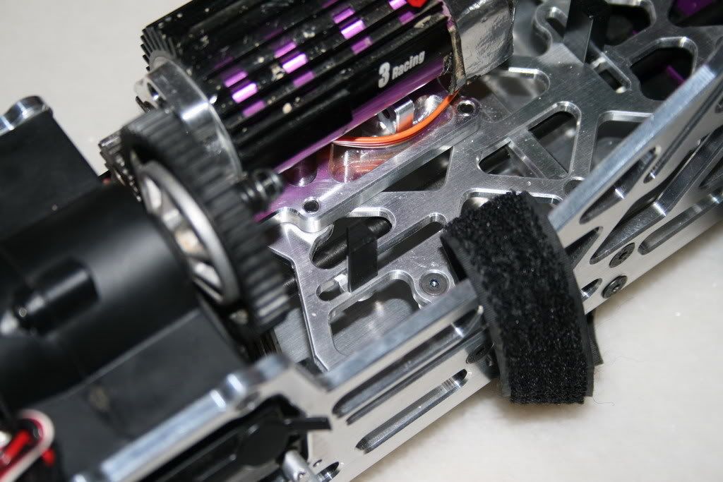

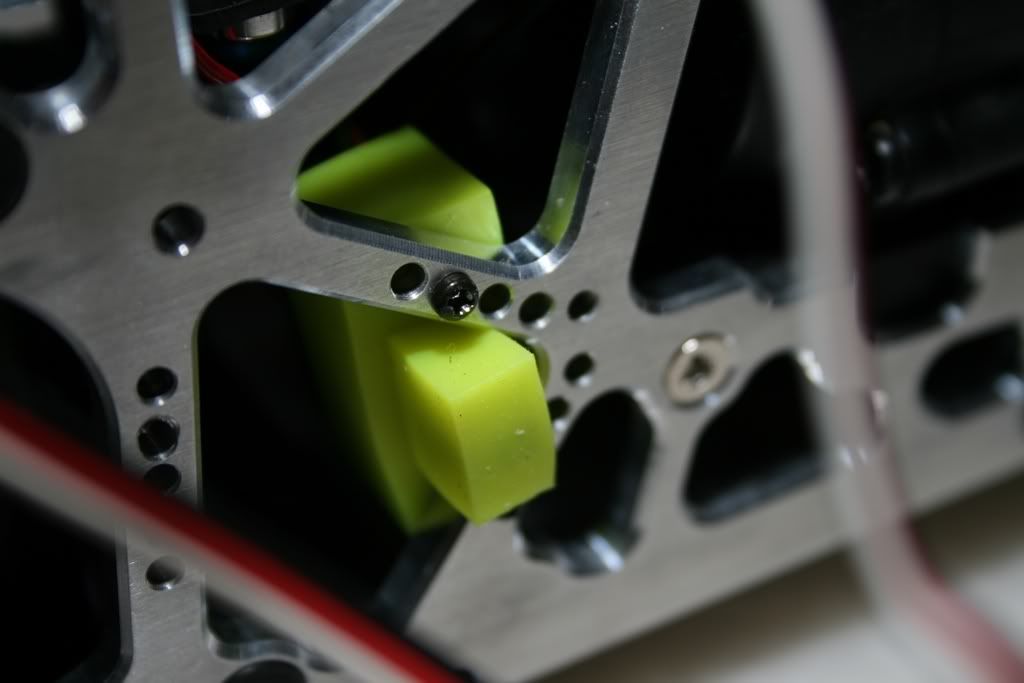

thats one of the sweetest savages I have ever seen. just clean up the wiring, and you will be ready to go. Is there anything keeping the battery from sliding forward? seems like it would slide in a hard crash then hit the slipper and tear a couple of cells to peices.

it looks like there is a little black plastic peice if you look closely.
awsome truck dude. looks great!

You could put some effort in wiring!

That looks great. The only thing I would suggest is that you make SURE that the battery cant slide forward and hit the spur...as that would create some serious havoc if it did (pack bursting into flames, setting truck on fire, etc).

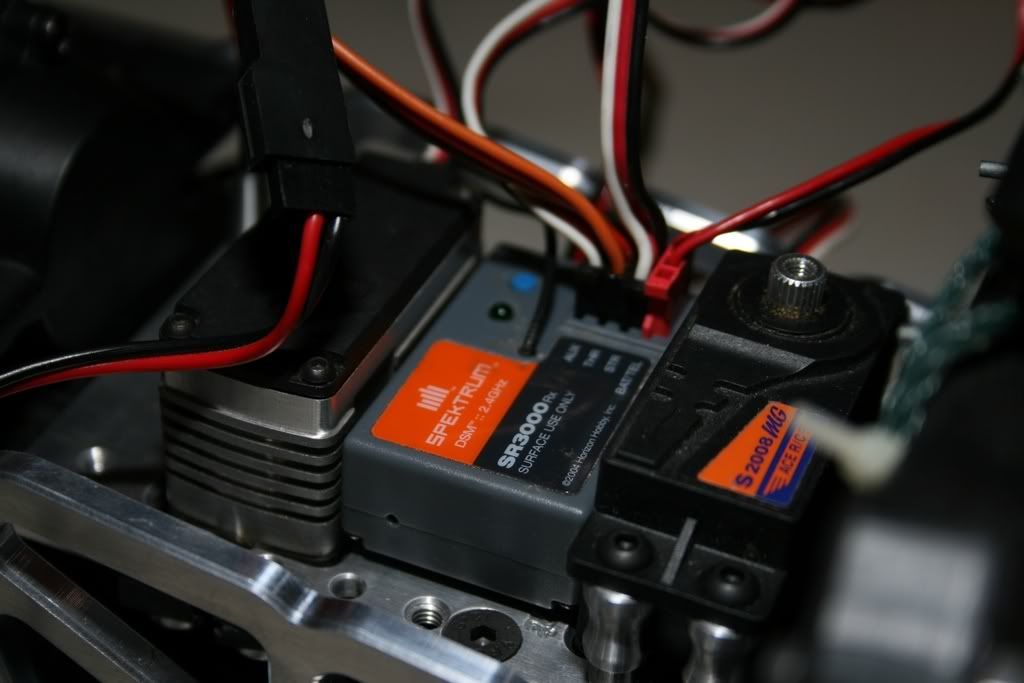

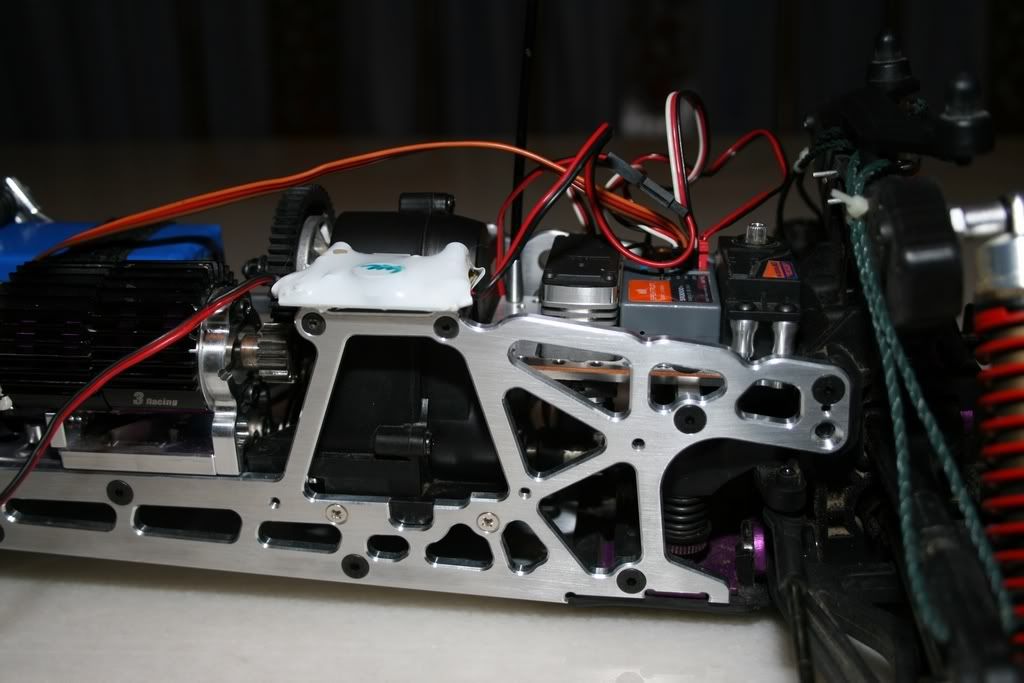

Wiring near the receiver & servo area

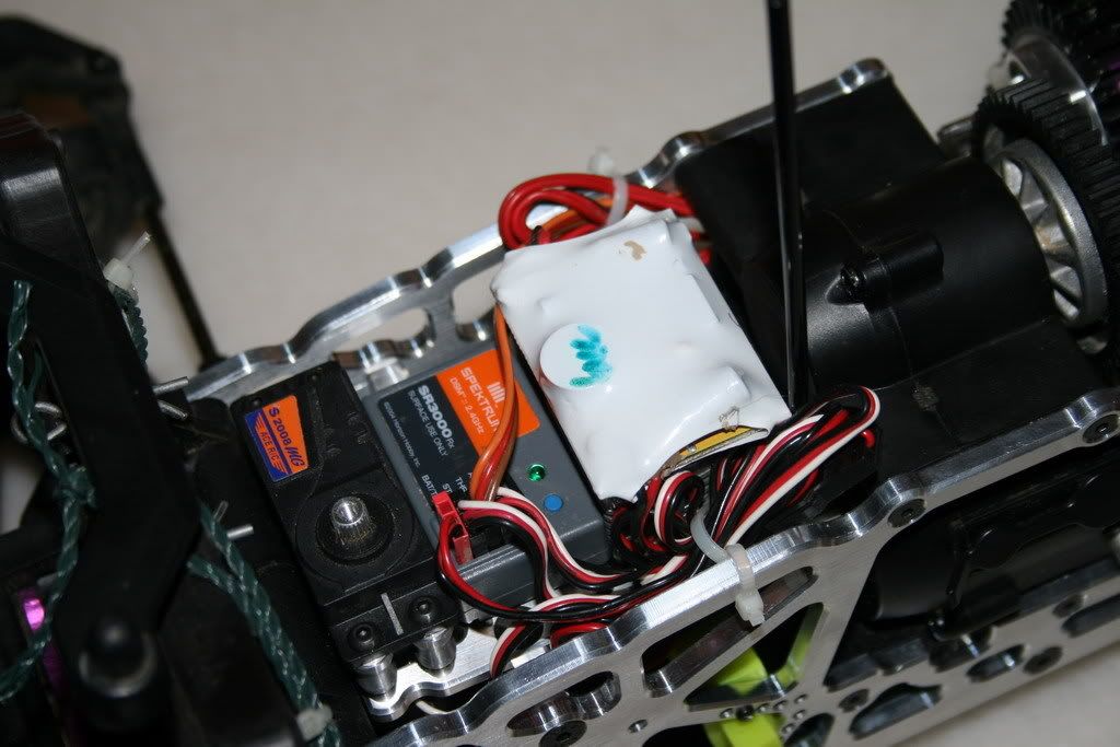

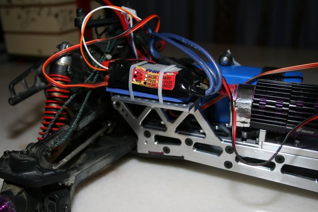

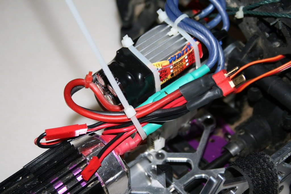

Wiring details near the esc area

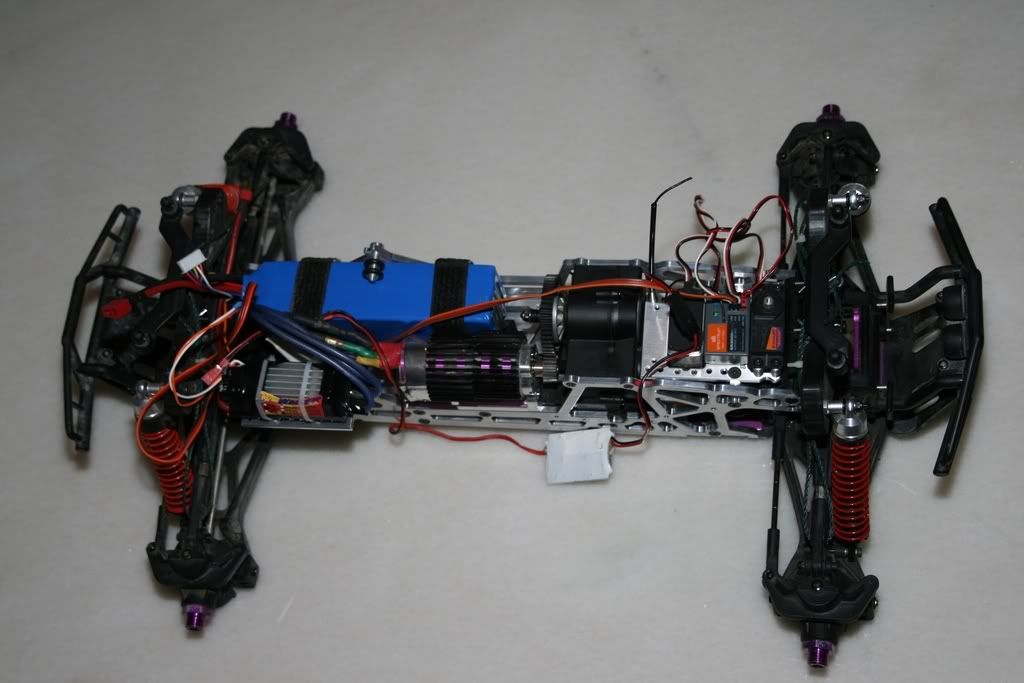

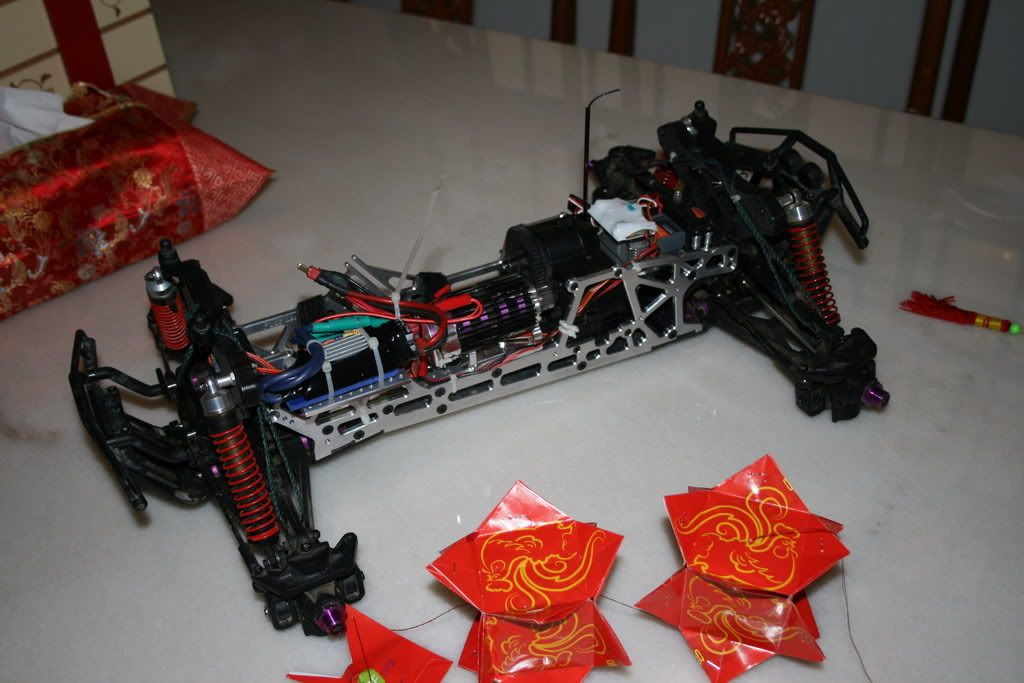

Chinese New Year is upon us on 07.02.08. Happy CNY to all !

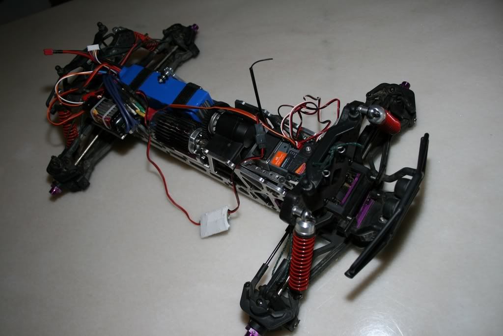

Another general view
Front battery stopper detail
Hi cemetery gates - you're right, those are tt shock towers. I think i must bought one of the last pairs before he decided to call it quits. This shows the age of my truck.
t-maxxracer32 is right - there is a piece of delrin stopper in the front to prevent the battery from slidng forward & gettint torn to bits by the spur.
Hi jhautz - I'm bought a 5S 5000mah from www.hobbycity.com for slightly more than USD100. Quality is a little suspicious though. Before I have even start to use it, one of the small wires connecting to the tabs has broken off. I had to open up the pack & do some surgery. Kind of scary considering that I was pretty exhausted late last night. I am using a 7XL with a BK9920 on 15/49 gearing. I was using this combo with 14cell Nimh in my old conversion. However, I was also using a 60mm fan blowing across the esc. I hope this combo is stable in this current setup.
Hi Serum - I'm a messy guy. My wiring is usually just an afterthought

What are the green pieces of what looks like rope holding your suspension from extending all the way? Is this something you made or something you bought. I am looking for a good travel limiter for the savage.

Sorry for missing the answer on this. This is a tip I picked up from savage central. Essentially it's just a piece of nylon string/rope or equivalent that u can buy from local hardware store. I rope it round the tower to the thingie (what's that word) connected to the tie rod (rod end ?) at both ends. The main intention is to limit the over extension of the shocks to protect them when the trucks lands. A crude equivalent to what droop screws do in a buggy or truggy.
