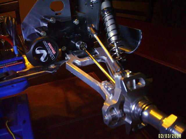

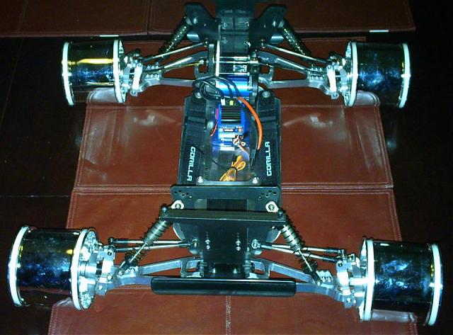

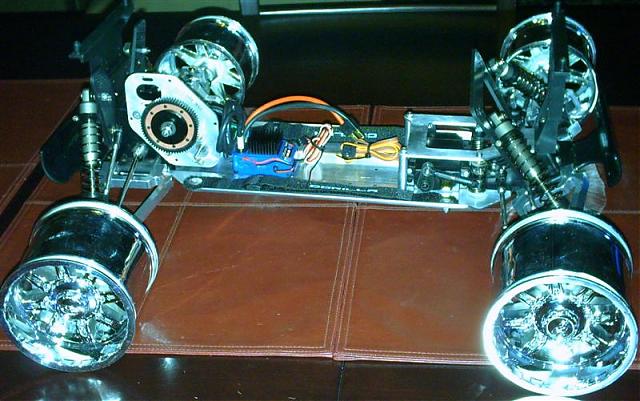

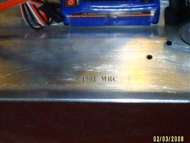

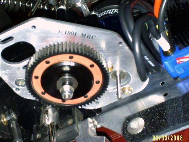

MRC Electric Thunder King. Built in 1991. World Scale (1/8+). Awaiting parts to complete project. I have one vlx system installed, awaiting the 2nd system. Rebuilt stock aluminum shocks and polished all stock aluminum chassis parts.Will be removing stock body post towers and replacing with aluminum extended body posts. Final weight will be in the upper 10lb range with dual lipo. Here is a partial list of componenets:
Dual VXL 3500kv motor and esc's
Dual 208oz TowerPro MG995's - Traxxas Servo Connector Y Adapter
HPI Savage aluminum suspension arms- front and back - Savage X Axles, Wheel Output Hub Shafts
HPI Savage Aluminum C-Hub Steering Block
HPI Savage Silver Extended 23mm Hex Wheel Adapter Set
XTM Mammoth real axle dogbones 138.6mm
RC4WD All Steel Gears
40 Series 23MM Cheyenne Chrome Wheels
Pro-Line/Proline Masher 40 Series Tires
Deans 12 Gauge Wet Noodle Wire Set
Spektrum DX3.0 DSM Radio w/ 1 SR3000 Rx
2 - 3S/6350 ZIPPY-H 5000mAh 3S1P 20-30C Lipos
Dual Gorilla Battery Straps

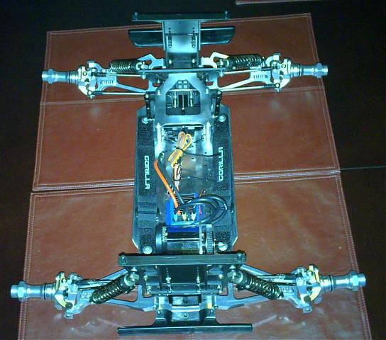

Boy, your just duplicating alot of my work huh?lol. Looks good. get rid of them crappy shocks. and change the direction of your shock mounts on the A Arms.
You'll get better control.

Thanks for the positive comments. Still have some work to do but the build went fairly fast. I like the stock shocks as they are very beefy and in new condition. I used associated 40w fluid. I will try them out and see how it goes. Team3six. One of the things I changed about my build is not using an elevated deck for the electronics as I wanted a lower center of gravity. I also used xtm mammoth rear dogbones as they are much stronger than grafting the two halves together. I should be receiving the 2nd vxl motor and esc in a day or two. I will post performance numbers once everything is sorted out. Thanks once again.

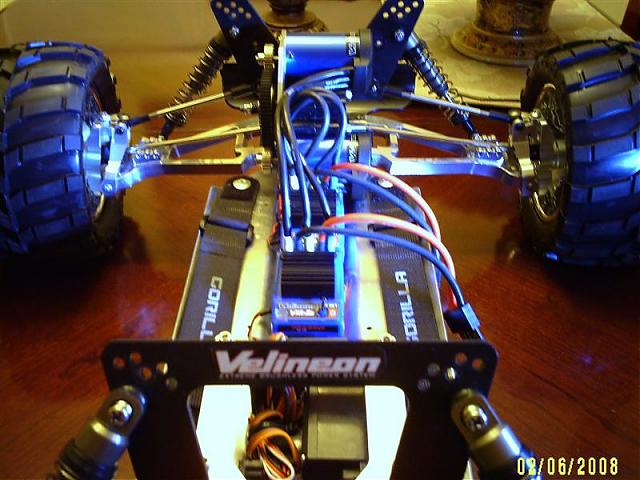

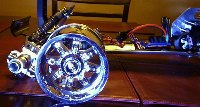

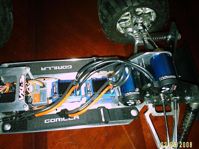

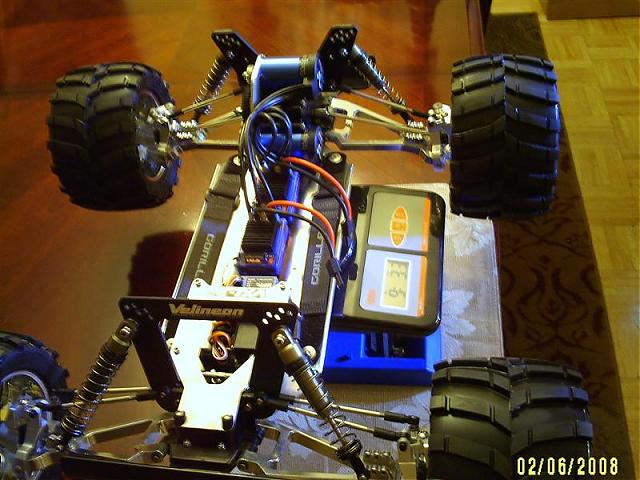

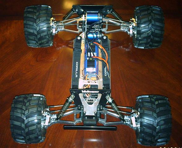

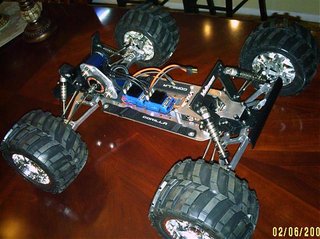

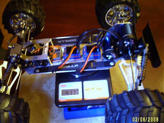

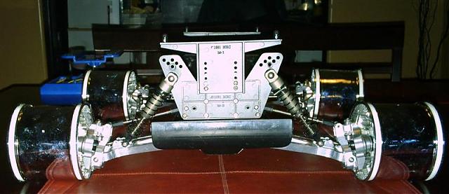

Here are some updated pics. I received the 40 series tires, 2nd VXL system, 32P pinions as well as the Spektrum DX3 system. I threw the new parts on and did a quick run. I am very happy with the system. It has a ton of torque and great speed. Wasn't able to open it up all the way as it was dark out and the tires are not yet glued. I blew both rear tires clen out of the rims. I have to finish setting up the spektrum and fine tune the suspension. I am still waiting for the steel gears and 2 - 5000mah lipos to arrive. I also ordered the JConcepts Illuzion MGT Heavy Duty Body. Will keep updating. Thanks
