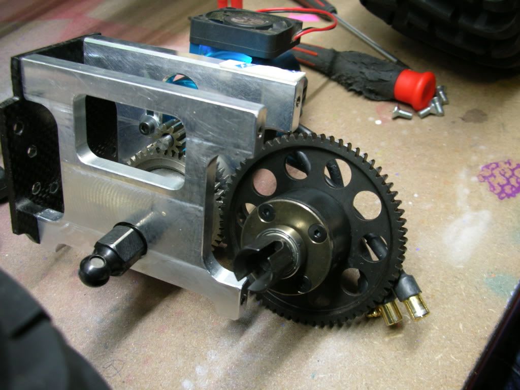

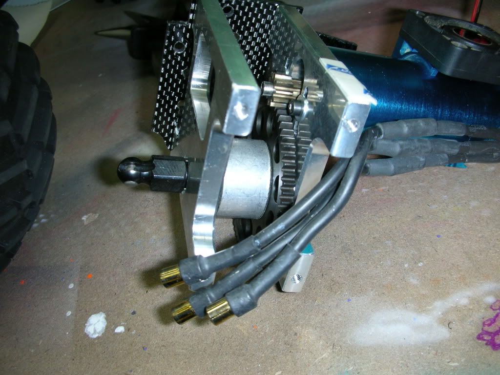

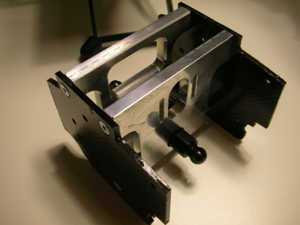

This is the original motor mounts made but a friend of mine, but he did it without thinking too much.
A lot of measures were wrong and i've made a lot of work to make it functional.

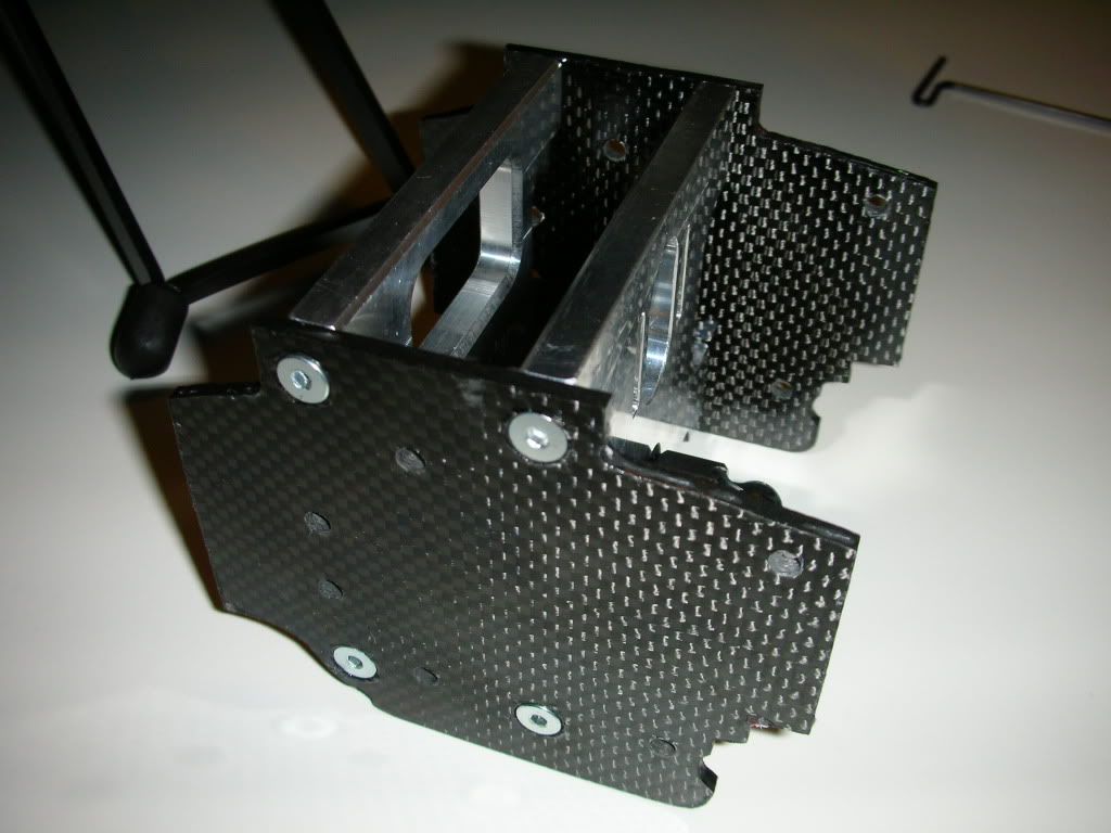

Distance between spur and pinion, holes for the tvp, distance from ground and position of the center diff are wrong. I milled the motor mounts by myself and builded two carbon plates to fit them in the chassis.
And this after some work to make it usable.

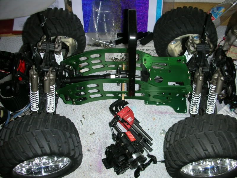

Some studies to fit everything in the small chassis

Wow... Nice. The CF plates look fine in there, and they allow you to remove the entire assembly at once for easier service.

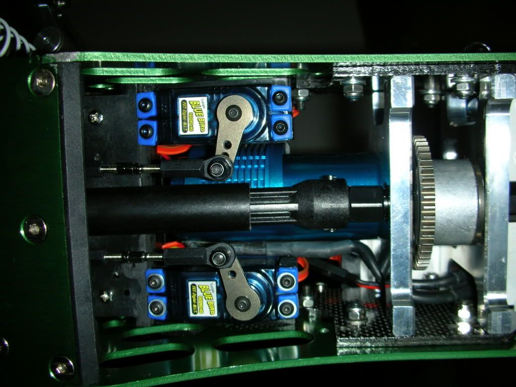

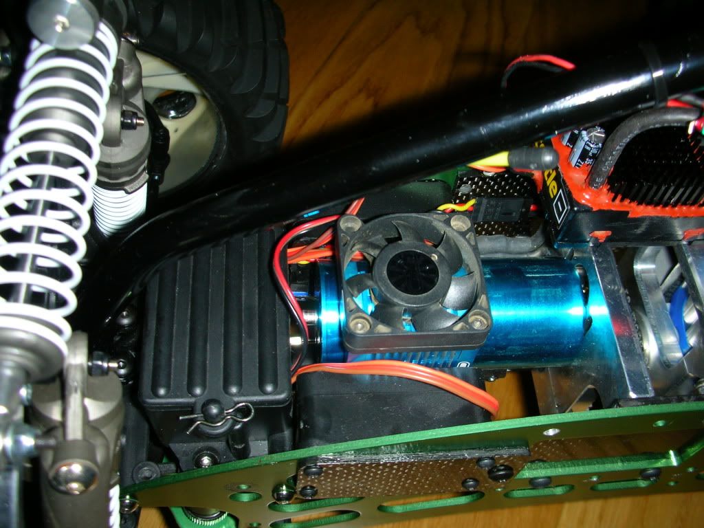

This is my solution form twin steering servos. A must in a monster so huge and heavy. Two bluebird digital with 14 kg/cm inside hobao servo mount.
General view with medusa 36-80-1600

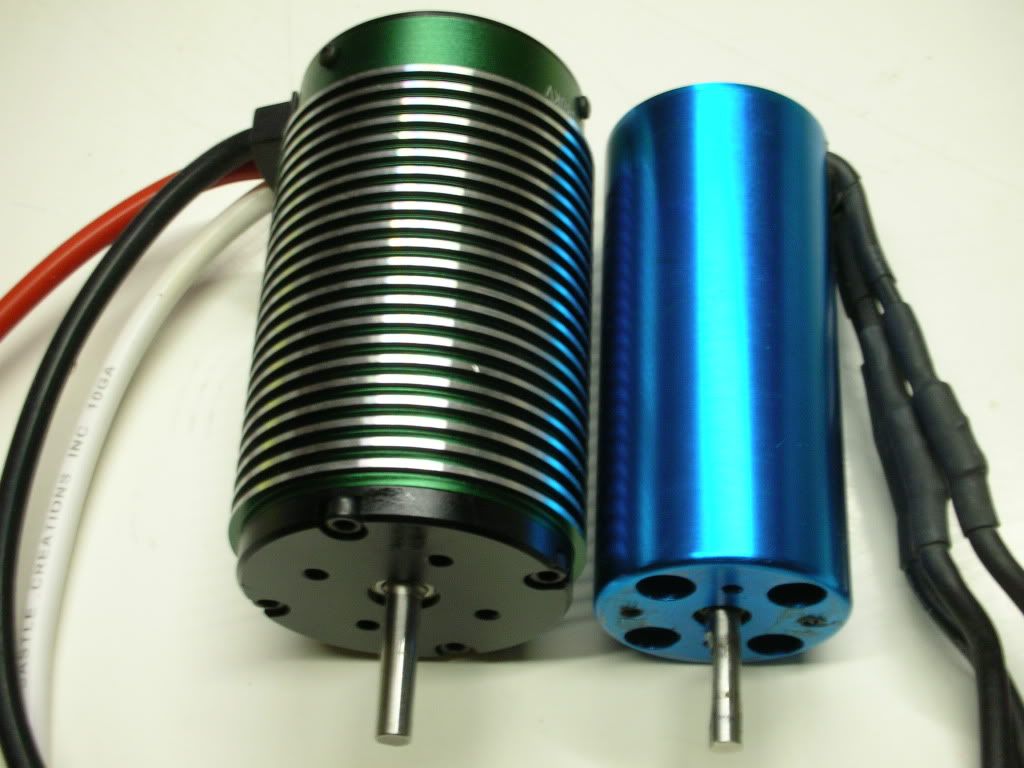

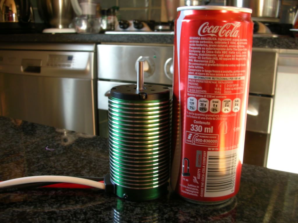

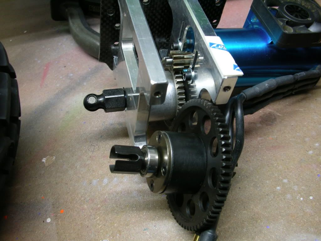

But with original spur and 11T pinion there was too cogging (another error not calculated by motor mount guy...)
So i switched a 66 spur instead of the original 46...

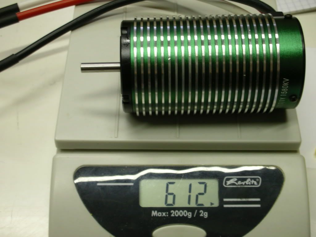

The cogging went away but for this Monster the medusa was too tiny so i changed it with a Castle 1717. More more power.

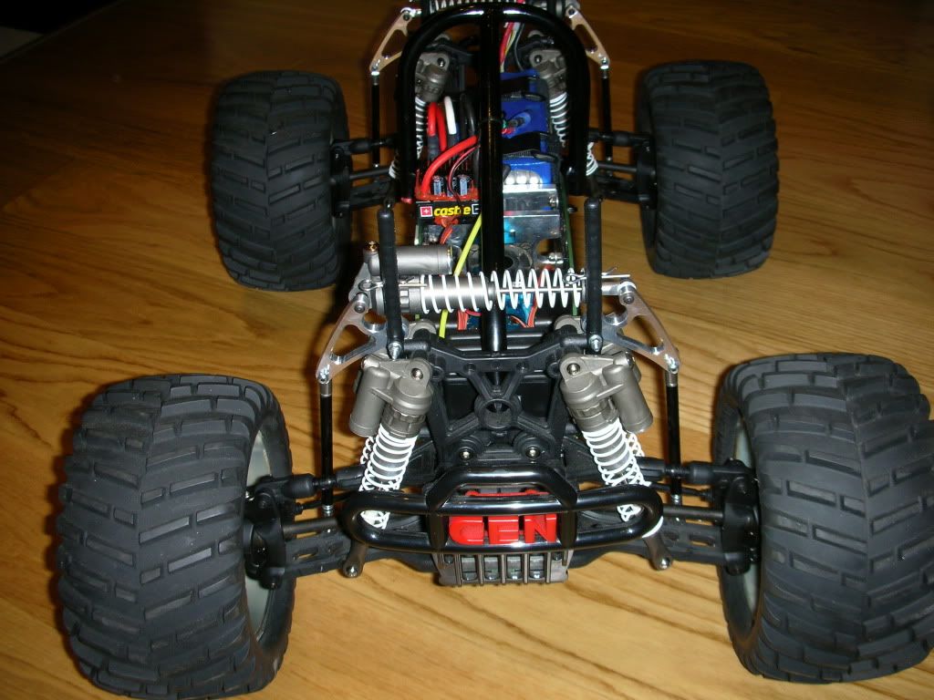

I like the strut/stabilizer setup on the front and rear
