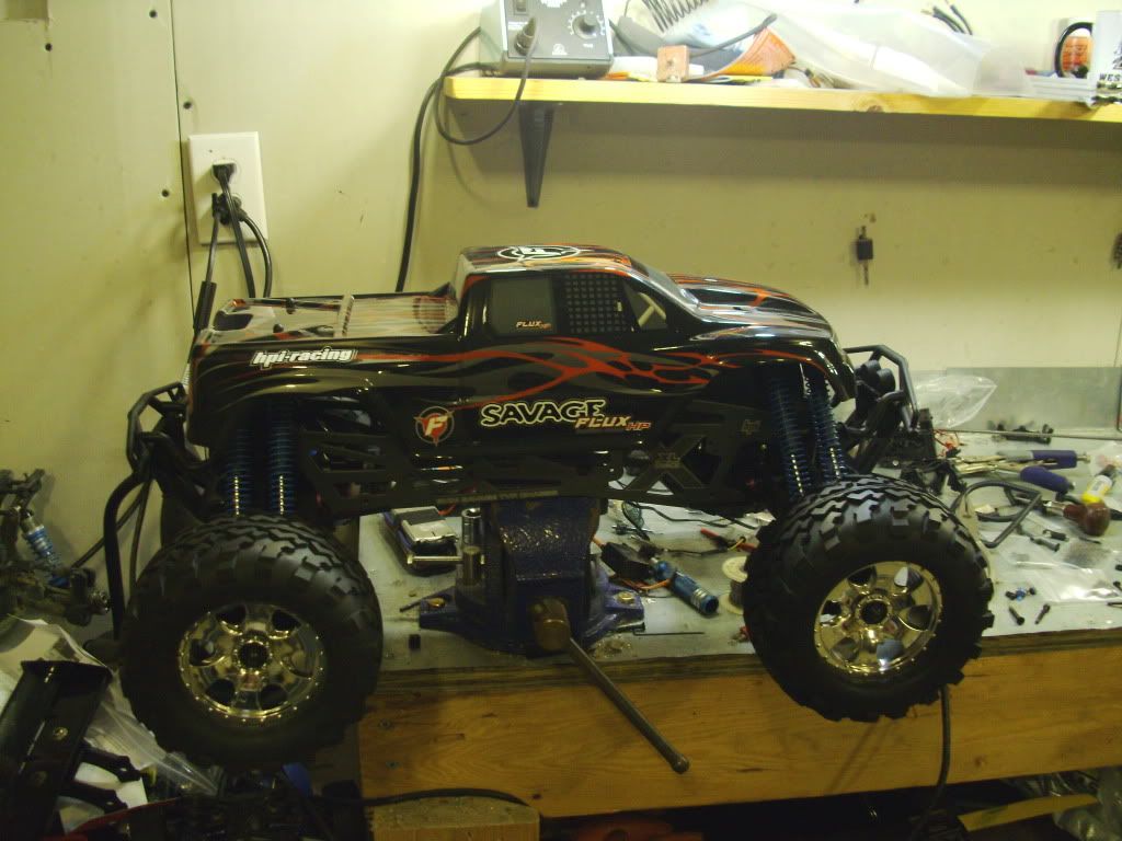

Flux motor plate will not fit on the xl tvps, both have HD driveline. xl is about 3inches longer. xl has 8 shocks vs 4... Ill let you know how my FluxL runs tommorow.

Does the XL flux look funny with stock wheels? And I think that the wheel cutouts on the XL body aren't so good, still looks a bit short, atleast that's what I managed to see from pics. :/

Looks awkward here but with weight on the suspension it looks amazing.. the xl wide axles are a must. makes the look stellar

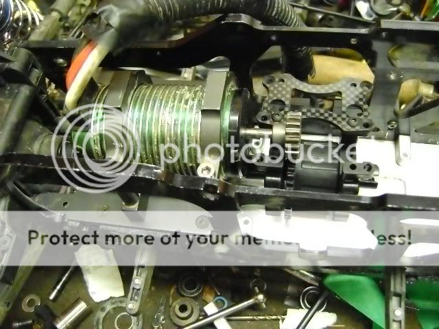

Well I'd be doing a TCS chassis - So its how easy is it to E-Convert an XL?
Yea, you need not worry about the tvps.
Its not hard to convert one. i did mine just fine. You will need all the 2spd internals for the tranny plus the idler. Most of the parts of the XL's 3spd are different. Its worth it to buy a flux tranny on ebay, or a Sav X 2spd plus the idler I mentioned. (I did the later to save some cash at the time.)
Other wise you just need a motor mount. Again, the TCS would be made for the Flux's. There are ways to make an L mount fit inside the TVPs, but its hard to adj the motor screws as its so close to the trans.
You can keep the shocks and anything else. Upgrade the shocks as you wish. Not req tho.
The TCS chassis can mount batts inside the TVPs, else you need flux batt trays & mounts. You can get a flux esc mount, or come up w/ something clever yourself.
Either way, upgrade the diffs to the BPs.
That's all you need to do really.
