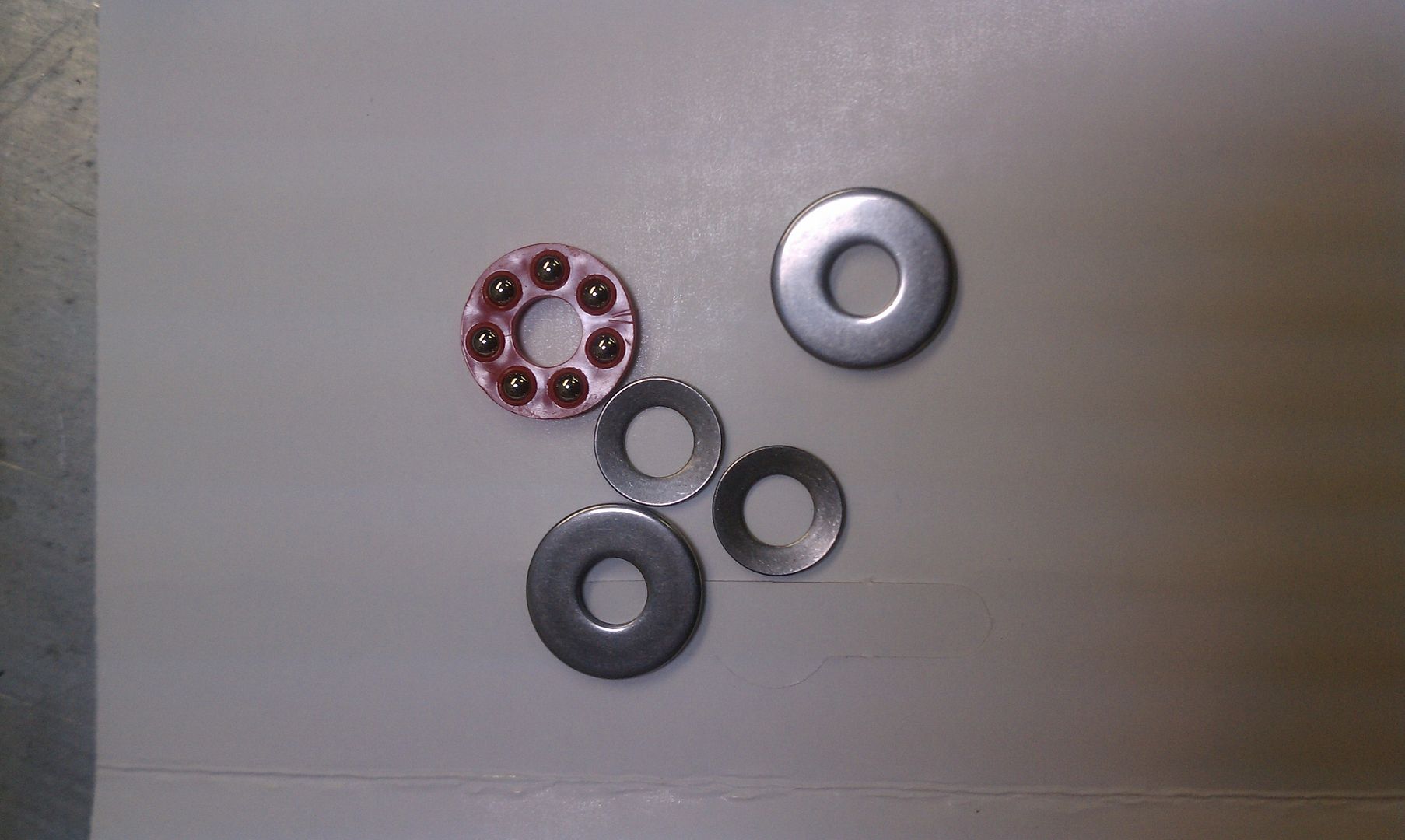

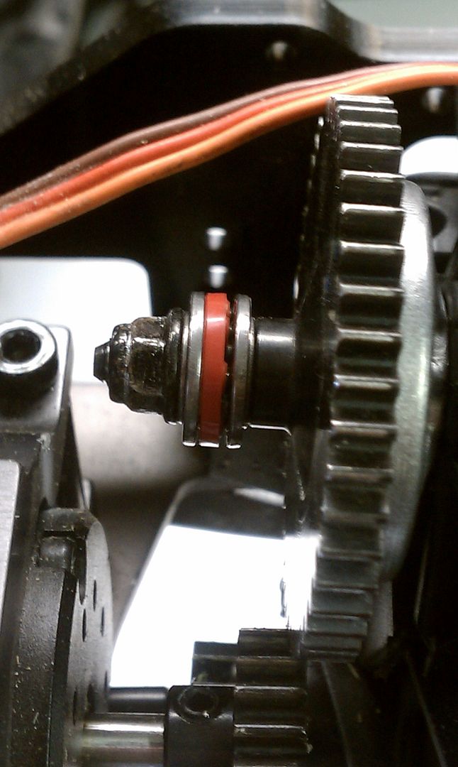

Here you go...
Working with my buddy Dan from Kershaw Designs, he hooked me up with a Slipper bearing set up that is designed for high voltage RC's.
The set up is two washers with bearing in between. The key to the design is the concave washers on the outside that keep constant resistance on the bearings and nut.
I took it for a quick run last night and she is alive.

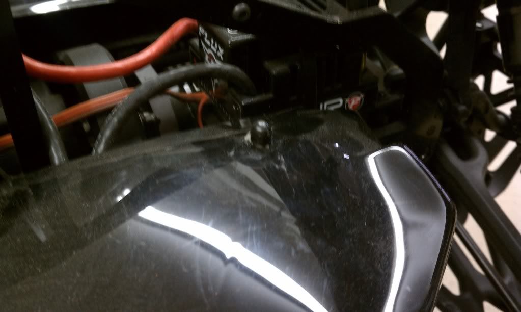

Originally Posted by NickRummy View Post
Nice! Are you using a steel spur or plastic? Are you still running the stock flux motor? I just posted a thread with my project.
Steel spur and stock motor. Haven't had issues with heat. I see you are running wider tires. I'm running 5B Trenchers. The tread is harder and narrower but they are heavier than what you are running.

Yeah I run (or ran) the same KD thingamabob... just cinched it down tight.
