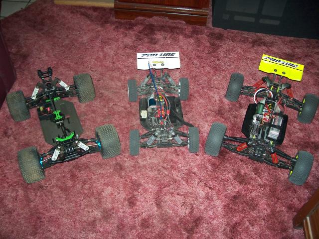

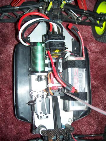

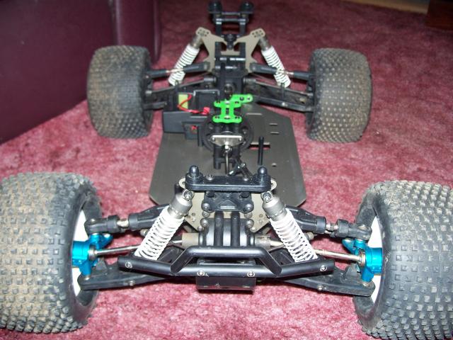

Think ima just say the heck with 5s and run it on a fat 4s pack,..seems to be the way to go with a 2200 combo anyways,plus it will live longer.Then scoop up an 1800 later and convert that Mutilator into the Defacator !
ID:	6304   Click image for larger version
ID:	6305   Click image for larger version

02.07.2009, 02:13 AM
Originally Posted by Dragonfueled View Post
Hey GreyGhost I noticed your running the elite 35c 4s pack. How do you like those cells? I just ordered them for my brushless sc8 project
In my mbx5t with a mmm 2200 combo,they laugh at that setup.Really run cool and the power is awesome geared 14-46.They run about 10 degrees above ambient,and I tried a lot of set ups and couldn't phase them after about 20 runs with a bunch of on-off throttle and flat out speed runs.I always balance charge them and at first they wouldn't charge up to 21 volts.But after a couple charges they have settled in nicely.The last run,fully charged,I got 15 mins run time and still had over 18 volts reserve. Money well spent Forgot to mention I tried all the suggestions here to cool my motor down and the thicker center diff fluid did the trick ! Thanks Sammus.And all who responded My mbx5t is a real bad azz truggy now and most of all is fun and SAFE to run.
