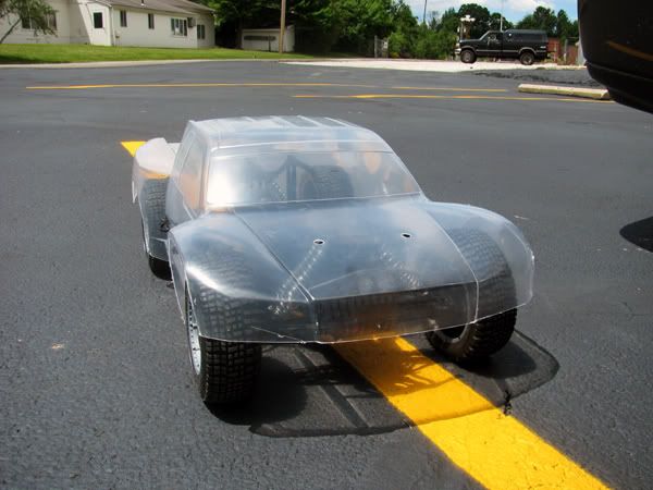

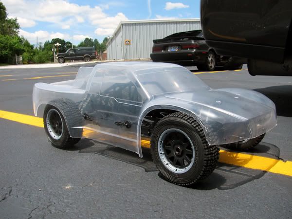

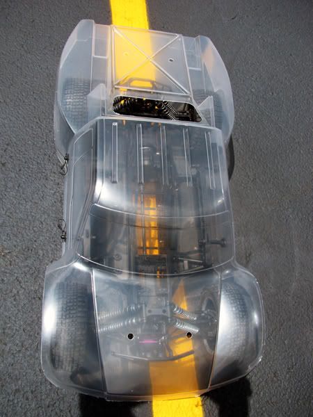

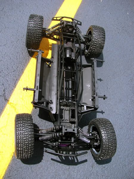

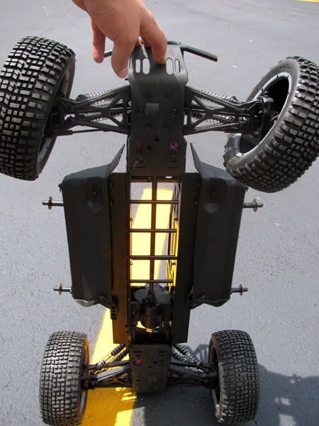

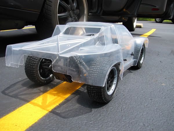

It's nice to see some good progress FINALLY. Finished the plastic mock up channel and mounted up the side rail assembly with the stone guards too. Actually worked out really really well. Putting the flux battery boxes back on is going to take some serious thinking though.
I'm going to make a center skid. The stone guards cover up the sides nicely but the open bottom of the TCS conversion bugs me.
Some body on shots. Springs are really soft and the plastic channel for the body mounts is sagging but it's pretty close to the ride height I'm going for. Can't wait to get in the XL axles to widen out the track width.
Time to make the aluminum rails since the plastic ones worked out well then start assembling the front and rear bumper assemblies so I can get started on those.

You could also just put the batteries inside the TVPs. Granted it does raise the CoG a bit as they have to sit over the driveshaft; see my thread for what I did.
Seems that it needs to have a slightly wider track.

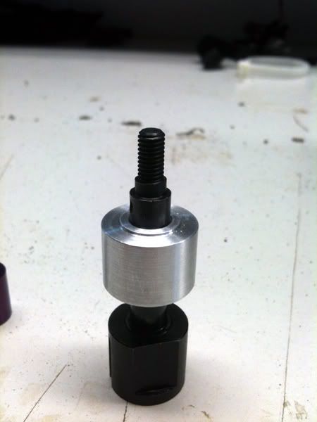

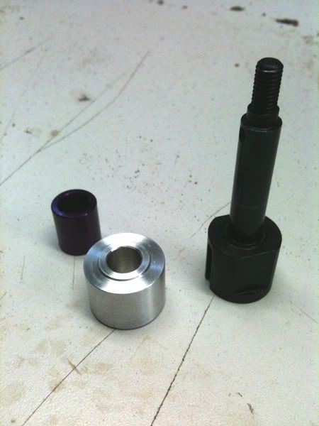

It was sloooooooow weekend in the RC shop. Way too much to do around the house and for the holiday. I got nothing done. Almost!
I did get one of the spacers done for the 24mm hexes. I'm hoping these will help beef up the axle flex.
XL stub with stock purple spacer and new larger spacer
Here it is in place. My thought is that since it's sandwiched in between the hex hub and the steering knuckle this will help cut down on the amount the axle can flex on hard landings, hopefully keeping the threads from snapping off like they're known for?

Looking at the dimensions of the stock purple spacer:
8mm x 12mm x 14mm (length)
Do you have any dimensions you can provide for your spacer? I am guessing that it may be 16mm or 18mm on the outer diameter
In a pinch, could you use say two spacers or bearings in say the following dimensions:
8mm x 22mm x 7mm
and come close to accomplishing the same thing that you did in your opinion?

What you've created looks alot like an extended hex, except that it is in 2 pieces. What about taking an extended hex with an 8mm bore, and drill a hole for the drive pin in the correct location. It'll be all one piece, and might support the axle better. Only issue then is you might want to use a sleeve or something on the threaded portion of the axle. Just an observation, and throwing out an idea. Cool truck man, I love those bodies.
