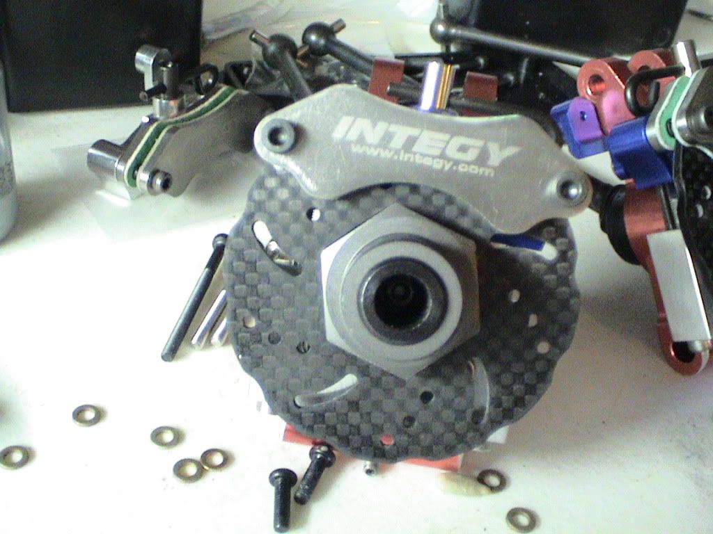

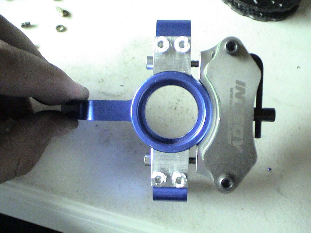

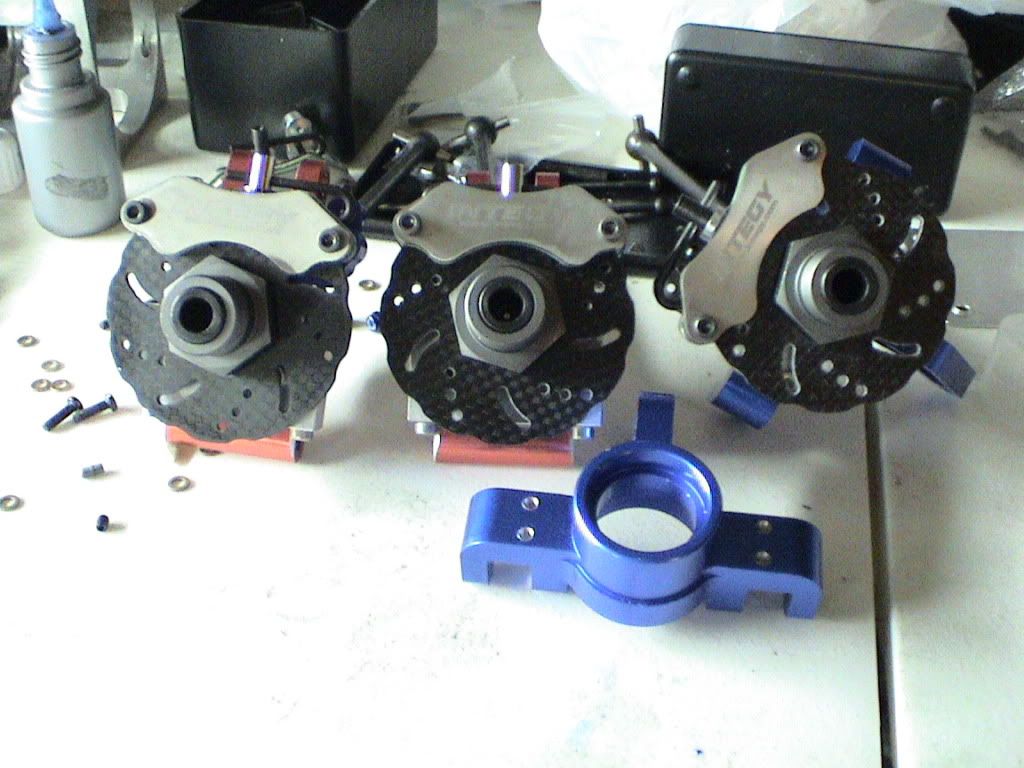

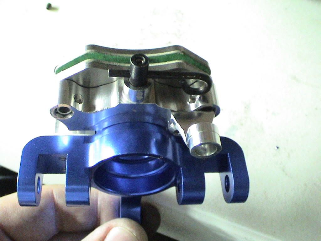

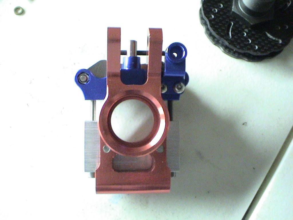

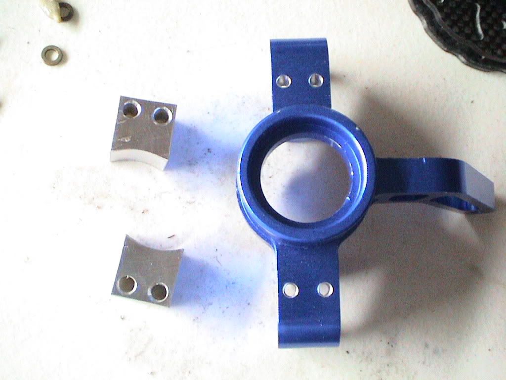

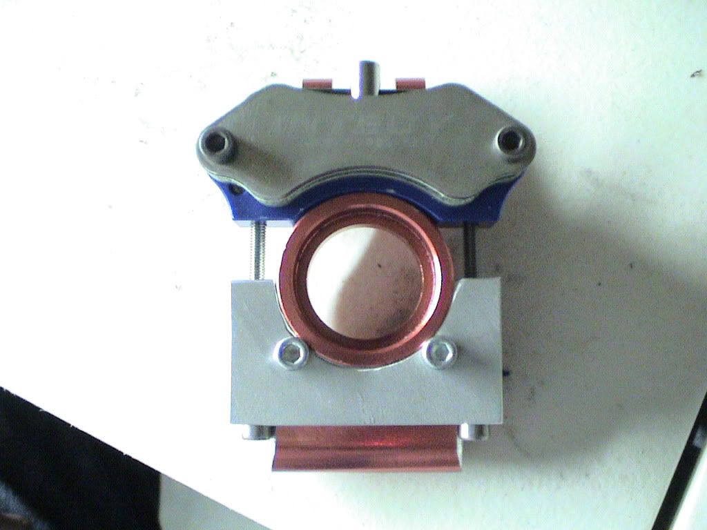

well my plan was to get the esc all hooked up tonight since i have the bec and everything now but since my machinist finished the parts for my hubs i decided to work on the disc brakes instead. here are some pics. tomorrow will be esc day and test run without brakes. i need to order a couple of parts to finish up the brake system. probably gonna be another week to get the brakes finished but i will try to get a video before then. there are a ton of small, time consuming, mods needed to make these disc brakes work.
to make the disc brakes work i had some small aluminum blocks made that attach to the hubs and then the calipers attach to them. a few pics.

kaz, did you already get your brakes mounted? did you run into issues? its just one thing after another with these? i need to purchase some extended hexes cuz now the wheel hits the carbon disc before it even gets tightened down all the way. also the wheel hits the calipers so i need to grind out a little bit of material off the caliper or the wheels.

I did discover that a 200 ounce servo pushing cable brakes seems a lot weaker than a 200 ounce servo running the stock Rampage brakes.

hmm. yeah when i mounted my brakes on the stock plastic parts they worked fine, with the exception of needing to take out a little material to allow full steering throw. the aluminum parts are different in size and shape slightly so its been a little tougher. actually after looking at things again some extended hubs will take care of everything. they need to be extended by about 5mm on each hub though. i dont know if there are any that extend out that far. again i am using 24mm hubs. you know of any? i really like these uberRC hubs. i cant use the darksouls cuz they are round where the discs would be. so i need a hub that is hex shaped throughout.
http://www.davesmotors.com/s.nl/c.88...t.A/id.6349/.f
these uberRC hexes extend by 8mm which is perfect but they only sell them in a set so i would have to drop $200 and then try to sell the fronts. d4mn. didnt really feel like doing that.
