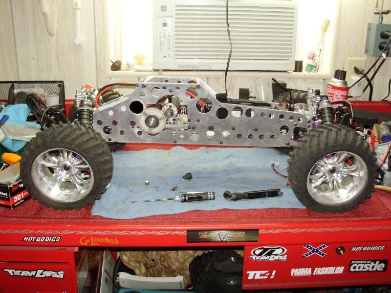

Looks unholy... except it's really holey!
I wonder if 3/16" will do it...
Yikes, I would not want to be hit by that!
Coming along well
I named it "Holey Moley"

Holy crap! Where are you mounting the turret, bc that thing is a tank! Nice use of the LST trans.

I have completed a bit more progress today but no batterys for the camera ? DOH ! ! !
I tried quite a few different blades and found I was happiest with the blade labeled for "thick metal". No idea how many teeth per inch, but it wasn't very many. I found a slow RPM cut best and the larger tooth blades didn't clog like the finer teeth blades. The one that worked best was one of the more expensive blades Lowes had so I assume qaulity meant a big deal because some unlabeled ones I had wouldn't cut a warm turd. Bare in mind I was cutting 2 pieces at the same time so it was nearly 1/2" of material.

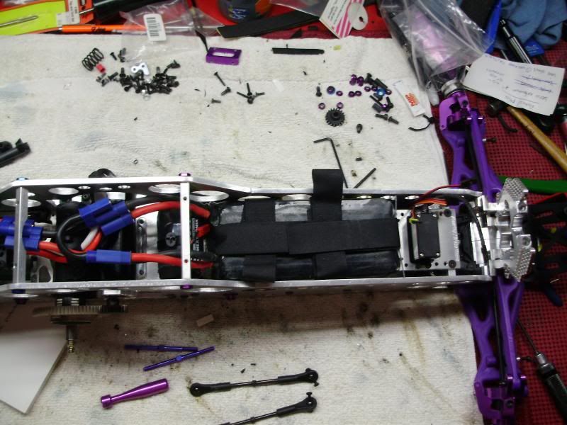

Finially had a productive day with limited interuptions.
Buttoned up a lot of small stuff today, ran the wiring(had to extend a few wires, I soldered everything-no plugs)
Shortened the servo wire
I decided to use a RX pack so I made a small shelf and installed it with a voltmeter for the pack. I will eventually go with a 2000mah 2s plugged directly into the RX and put all that juice to my Robot servo. 513oz torque at 7.2v. Scarey !!!!!
Pulled every screw out and reinstalled with a drop of Blue Loctite.
Made velcro straps and padding for running 2-4s or 2-5s packs. My 2 Polyquest 4500mah 4s 40C packs fit beautifully in the tray, looking forward to 8s power ! Will run 6s for now tho.
Tomorrow all I need to do is put together the titanium turnbuckles for steering, install the freshly built shocks, and do a little cutting and drilling to make the full lenth skid plate and install the RX and it'll be test time ?
I've installed a Mamaba Monster for now and will run 6s till Castle releases the XL-HV

looks absolutely fantastic!!! you have so much space to play with things inside the chassis!!!! what gearing are you running on 6s for the time being? im also impatiently waiting for the new castle esc to come out! POWER HE WE COME!
63/25 and it's a little under geared, I'm not going to drive it much till I get the XL-HV. No sense in torturing the M.M.M. ??

Yes, ESC is behind the trans.
OBTW, the chassis loaded with batterys seems to be perfectly balanced F-R.

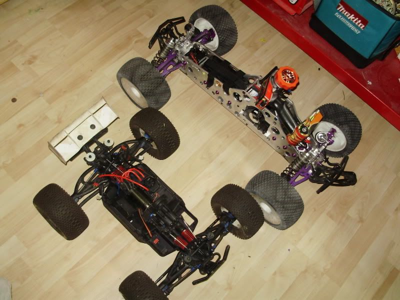

Heres a picture of "Holey-Moley" next to one of my ERevos for a comparrison of scale
I had a Baja 5B when they first came out, it was a fun ride, lots of power(with a aftermarket pipe) and easy to run and take care of. However it was "too" big, steering radius was severely compromised, the weight killed the nimbleness these RC's should have. I'm re-liveing all this while driving my Savy. Yeah it's big and badassed and all that, but truthfully I'm bored with it already. It can't scamper up a hillside and jump the slightest bump or divit like a RC 6-8lbs lighter can ? The layout of the huge RC lets you put the power down and the thing goes like a bat out of hell. It handles excellent and goes where you point it but the weight also makes the control arms flex a ton and not to mention harder on drive train IE diff gears,axles,slipper ETC
It is truely a unique RC and I had a lot of fun building it but I will be selling it soon to whom ever might be interested in a large scale Savage. I'm gonna play and tinker with it another week or two when I can make time and then I'm going to break it down to a XL size w/CD (possible slipperential?) and sell the chassis and skid plate.
I have more fun driving my XXL/LST with the 1717 & 6s personally ??
