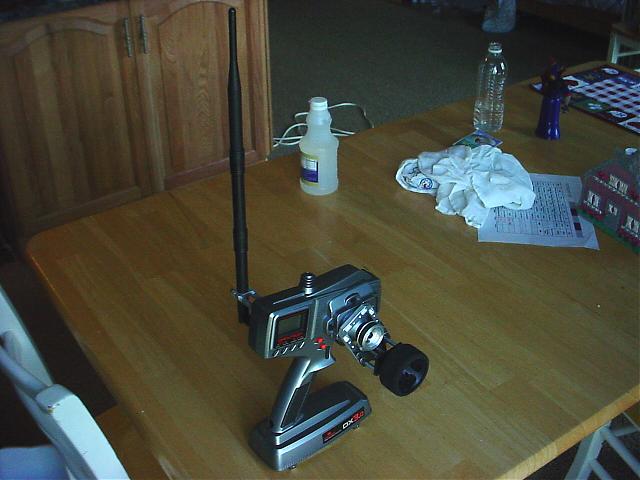

Here is my modded TX for top speed use. The steering throw is increaed 3X for finer control and the antenna is a 9db gain unit for longer range. I get 1500 feet out of this setup.
I do not mean to hijack this thread, though. Thsi is not my build up.
I am more than willing to answer questions, though. If you would like me to start my own thread, I will.
Matt

Love the transmitter dude... gear reduction?.. :)

Belt drive, 16 tooth pinion, 48 tooth spur. :)

That is looking good brian. Can't wait to see the top speed figures. Mod man that radio is almost as crazy as your car.
