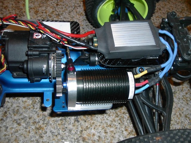

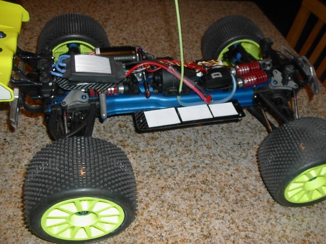

i thought i was the only cheapo around?? i have been trying out one of these my self. im running it on my revo with a neu 1515 2.5 on 6 s , so far its working . but on the third hard pass it blew my tranny. but by the pictures yours looks different, ??? yours looks like it has more caps than mine ?? my esc has 2 - 35 volt 220 uf
your looks like it has more than 2 ?

Yea, I added the caps in myself, which are 330uF 35V.
I had two suggestion today for replacement fets.
Fairchild FDP8860 and IRL3713.
Current fets are IRL3803. Any of you guys know which of the above would be a better choice?
