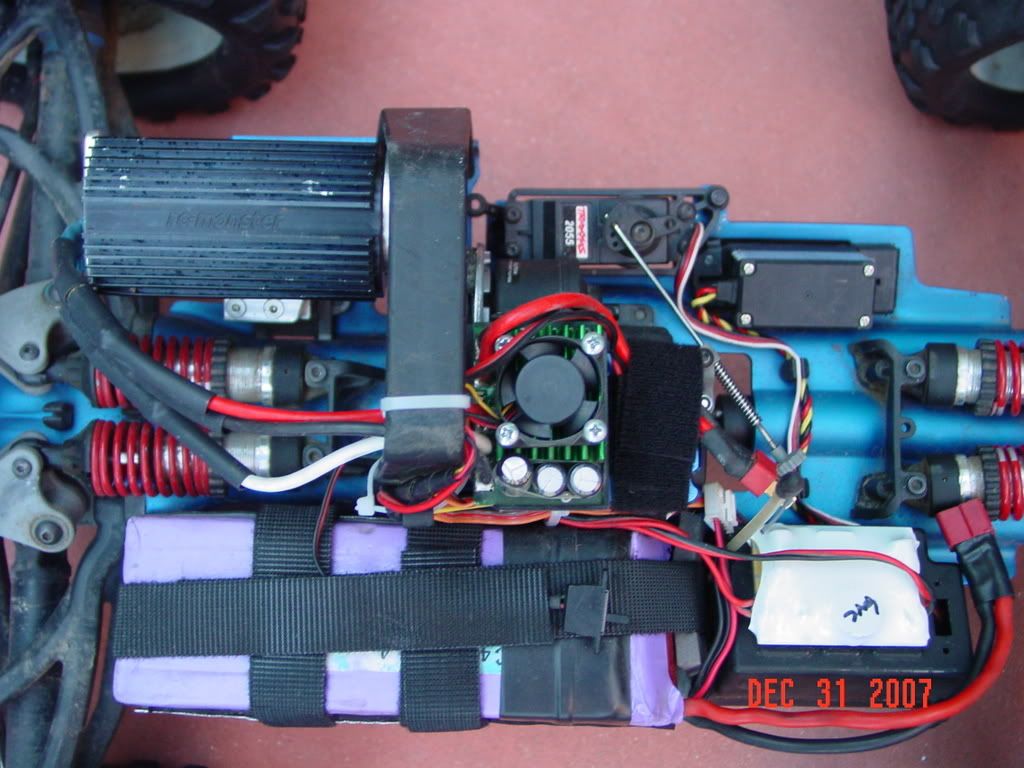

I don't have a picture of the actual motor mount, but here is a picture of the general layout of my E-Revo. The white thing is the external BEC, and under it is the Tekno Receiver box with receiver inside. At the moment, one servo (Hitec HS-5955TG) is working perfectly for me.

orangecrush - I didn't even notice that, but you are right, in the picture the motor does look crooked. However, in reality it is straight. If you still want to run 2 servos, you can mount the receiver where my brake servo is. This is how it used to be before I installed the manual brakes. I just made a small tray out of sheet metal and it worked great.

If you wanted to stay with dual servos, you could drop your RX where I have my ESC, since you have a Tekno mount for the ESC. See where the Mamba Max ESC is sitting? You picked up a Tekno radio box yesterday though right? I believe you have to use one servo with it unless you relocate it to a different spot on the chassis. Here's a picture of my layout.
