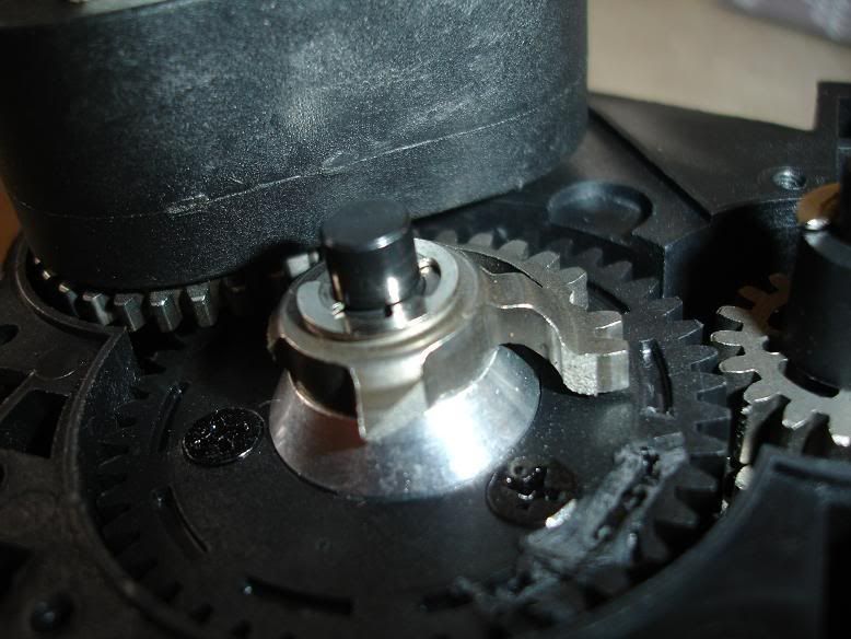

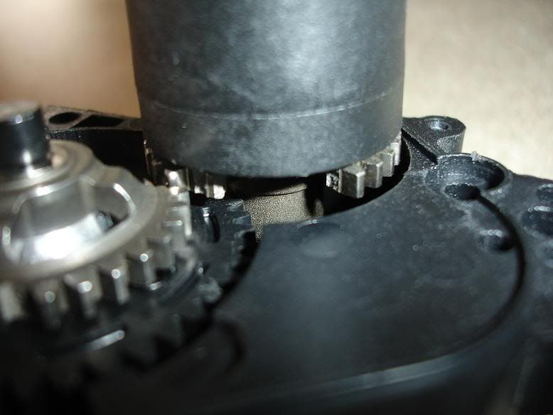

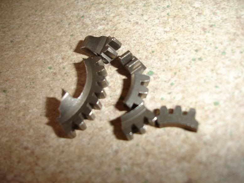

Here are the pics of the tranny after a few runs with my brushless setup. Looking to go Direct Drive or center diff with a higher powered motor/outrunner.

why do you still have a reverse module on the thing when ur running BL? is there a OWB?

mmm i love when the power eats trannies for lunch!

that sucks dude... did something get jammed up in there?...
Anything with an auto 2+ speed tranny will have a OWB. OWBs are put onto the 1st and in this case 2nd gears, so that when the 2nd and 3rd speed clutches engage those higher gears can spin the output shaft at a higher RPM than the lower gears do.

Well I plan to run DD outrunner or use a buggy center diff so that should eleiminate the problem alltoghther. Ill let you guys know what happends.

And no their was nothing caught in the tranny. It was clean and ran super smooth. My guess is that some of the glitching caused this to happen...

I noticed there wasnt any grease in any of the pics. Arent you suppose to grease the transmission?

I cleaned out alot of it before I took the pics so you guys would be able to see the broken stuff.

Most of the nitro savage guys run them without or with just the lightest coating of thin grease. They run smoother and last longer that way.
