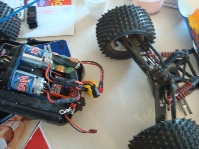

Deans for now until i get the MMM.
One thing i do to keep dirt and maybe even water out is to shrink tube (3-4" long)the two deans connectors together then neatly with a razor cut the shrink wrap around the base(wire side) of the female plug. This also helps the big finger guys by having the shrink wrap 1" down the wire on both sides for something to grab to separate the plugs.
Here is a picture to help, motors and esc were done this way.
