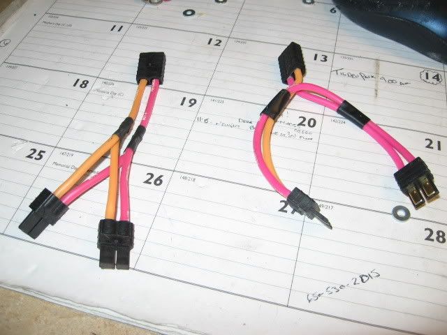

Here are two examples of wiring (Series and Parallel)
If I have this correct?? (sorry it late!) Series will provide you with more power but les run times IE (2) 2s 5400mAH would equal 4s 5400mAH
Again if I have this correct?? (sorry it later!) Parolee would provide you with 2s 10,800mah (IE) longer run times..
