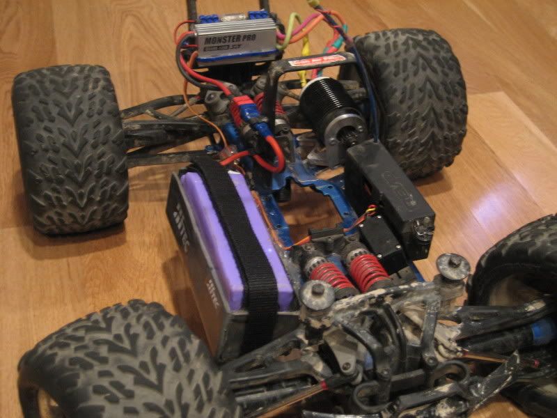

Any pics of your wiring?

This is the only pic I have. The reciever is close to the motor, but It has ran fine the first 5 times I drove it.

For testing purposes I moved the reciever as far as possible reset the remote and still had the problem

Do you have a second spectrum receiver to try? I've heard of something inside the receivers coming loose occasionally, maybe that could me making it act strange?
I've been using a DX3 with a quark 125 for about a year and a half, but I've never had any sort of glitching issues.

If you are running an external BEC try disconnecting that and running a receiver pack to eliminate the external BEC as the problem. The other thing that could be possible I suppose is the steering servo going bad and creating some sort of interference int he signal of the whole system, but I think the BEC is the more likely culprit.
