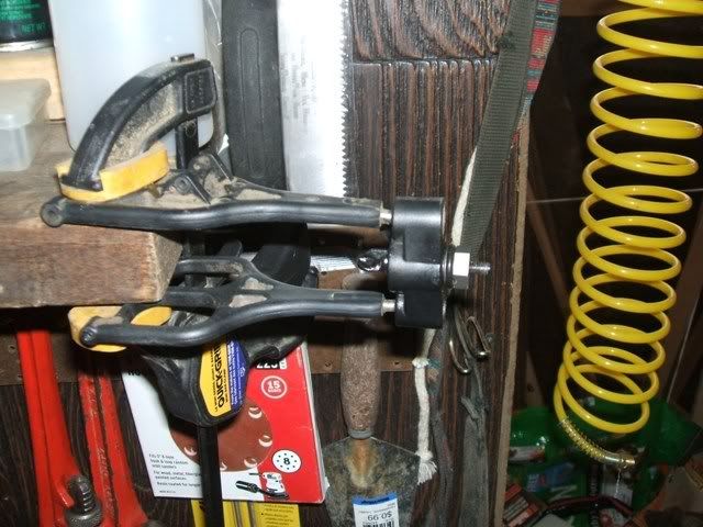

I took a couple of old arms and removed the shaft from the axle to use for a balancer. Some of us aren't as lucky as linc to have a prop balancer just laying around. Had a couple that were so out of balance I was about ready to give them away. Tried the golf tape and balanced them and they work great now. The epoxy putty is a good idea too.
I like the clamp and table idea. My prop balancer is just big enough to do a std maxx tire. I was going to need something like this to do my lst tires...
I like the epoxy putty but wish it was a bit heavier. My buddy gave me some sticky lead weights that are used to balance full size tires. I may try to cut them up a bit and use them!
