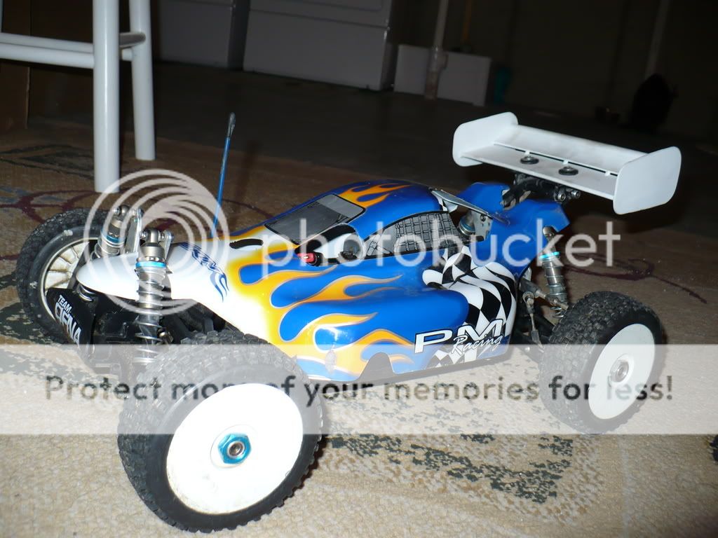

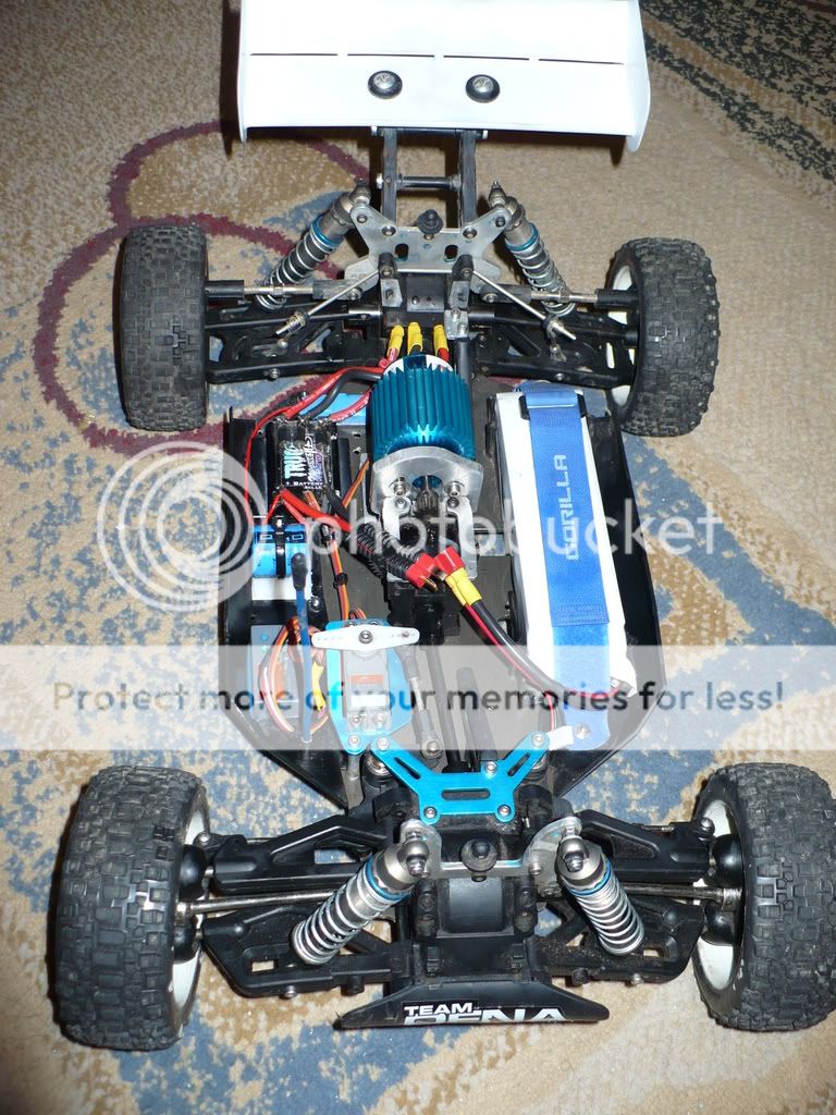

First off, I am always on a budget so there is nothing fancy onboard this buggy, all function for me.
This is a buggy that I picked up from a buddy for $40, it was basically just a bunch of parts in a box. I bought new shocks, wheels/tires and a few other random pieces and made it work.
Built the motor mount from 1/4" thick aluminum sheeting and dremeled it out. For battery mounting purposes I used the Associated battery cups because they were cheap and will fit any lenth battery.
This project started life as a NiMh brushless and I now got a 4s Zippy-R 4800 lipo so I have converted it over to lipo so it is now much cleaner. Anyway, its been a fun project and I will improve it more I am sure after get out and hit the track with it.

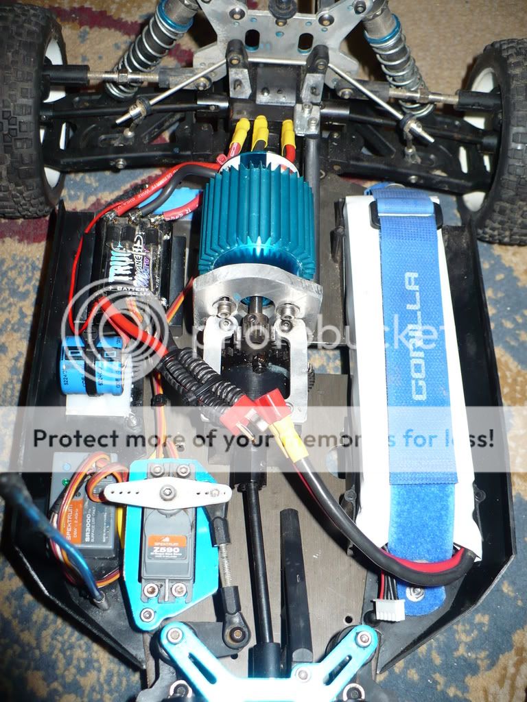

Can you give some info on the ESC set-up? Are they capacitors?

That is a serious conversion. Nice work. That is a massive capacitor too. Looks like you could run the car just off that cap.

The capacitor is just like all of the smaller units that alot of people run on their ESCs to help with power delivery. This ESC came with that cap right out of the box. I am sure that several smaller caps would work better but since this is what it came with, thats what I have been using.
As far as the ESC goes, I have been running it extremely hard for about 4 years... it is by far the most reliable piece of equipment that I have used. Zero problems, totally waterproof, handles 4s or 12 cells. I have ran 14 on it quite frequently though. It is only supposed to handle 80A cont. or 120 burst but I have ran a 8XL on it for along time. Just got the Medusa and lipo, hopefully the controller can handle it, if not, I figure a MM is in the future. The ESC is large and heavy but very reliable.
