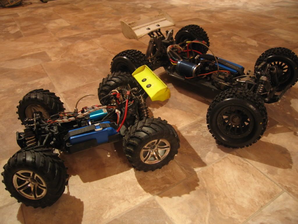

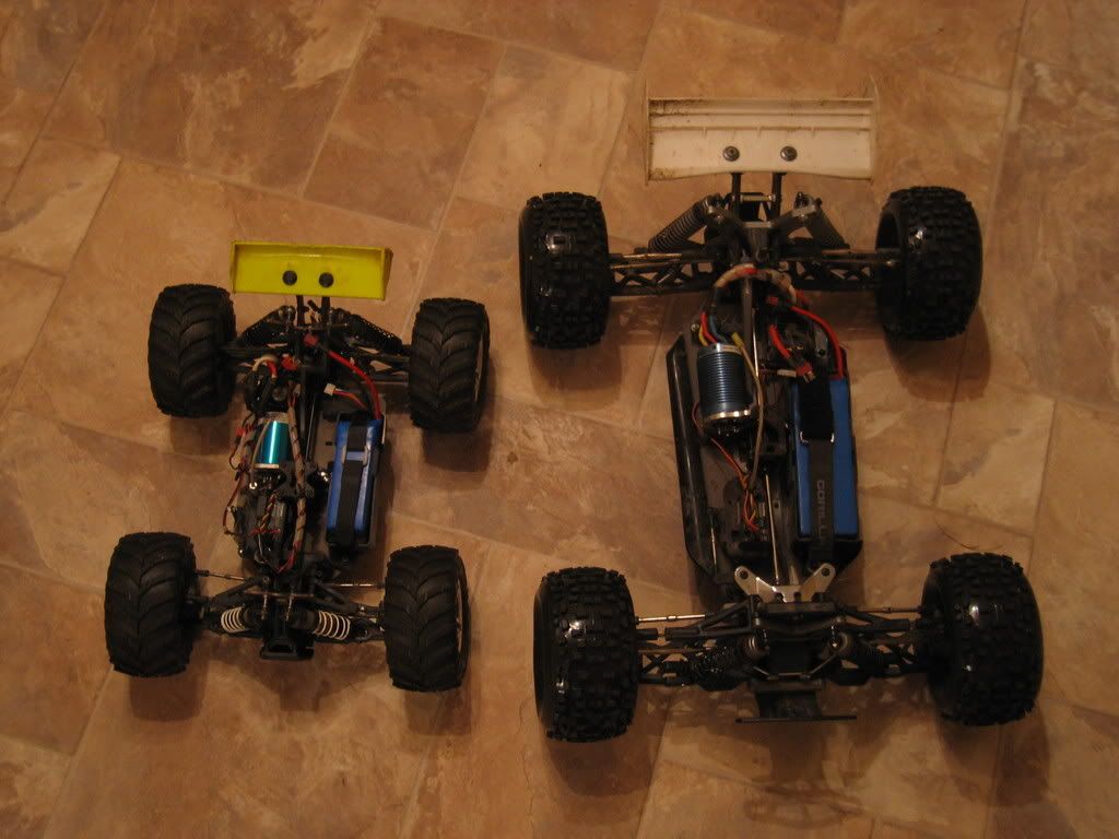

Well, went thru a 12S after the 1/8" shaft snapped, then snagged a 50mm 2200 kv medusa, and now I run that on 4s packs. Very nice, and very reliable. Got some 4S 30C 2100 Zippy packs for less than $40 and they freaking rock. Standing backflips easy if you are not careful. Also did the BB shock mod a while back as well. Essential. Led lights were removed in front until further notice. Bad crash damaged one and haven't fixed it yet.
3K front diff/10K/2K
27.5wt oil in Ft on jato pink springs
35 wt in rear on HPI blue springs 71 gF/mm (from hellfire, slightly lighter than the LX1 yellow springs)

ET Data on newest setup: 13/46 gearing on Medusa/4S and Masher tires. 90A peaks on a half spent pack and I was only dropping 2V (3.9V ->3.4V/cell) That's a 43C load!
Pics:
(Crt.5 vs Hyper ST)

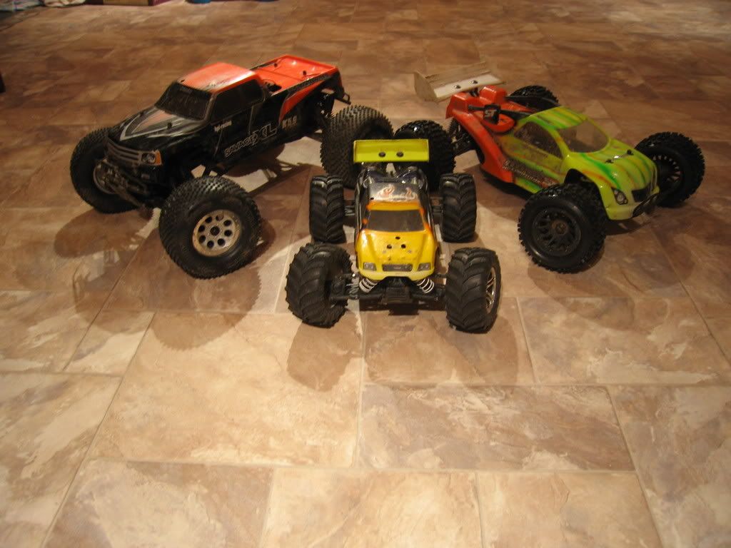

The Fleet:
