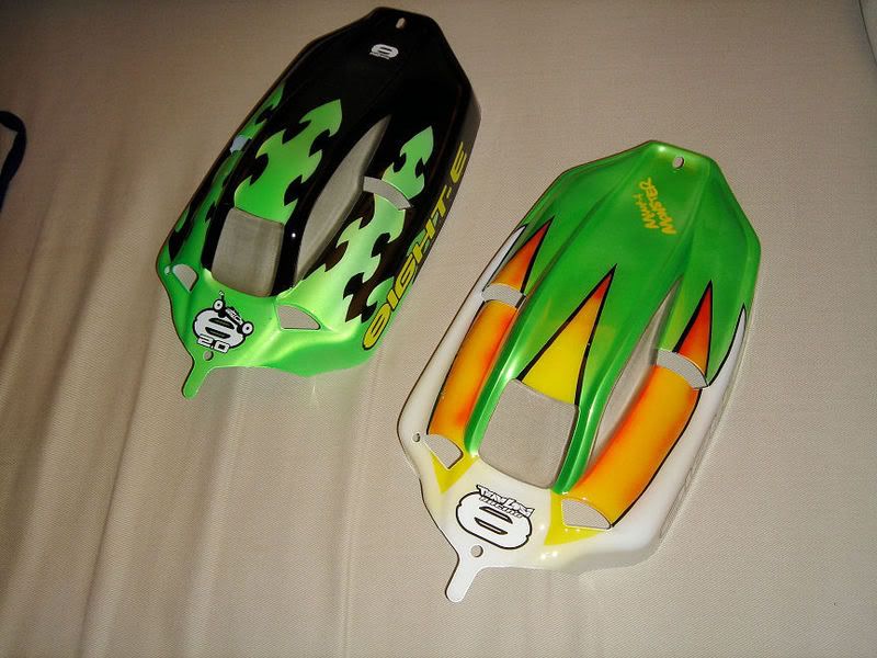

Well I finally got around to painting a couple of bodies. I am not very good at painting so I stuck to some simple designs. The reason I have two bodies is because I was so excited to see the "E" bodies back in stock I ordered one without remembering I had one on back order as well.

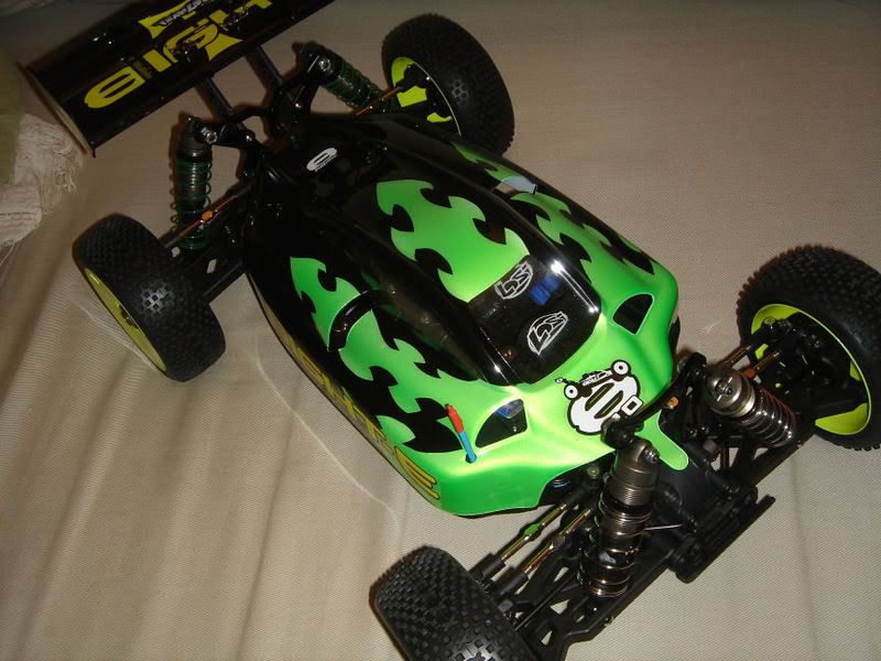

Also, I added some 3M HD dual Loc velcro to the bottom of the tray and added some padding. All of my batteries (except the Losi hardcase) have Dual Loc on them. The the Losi tray is really long, which is good for adjusting weight bias. But, it is bad for short batteries because they tend to slide forward. With the velcro and straps the batteries stay where you put them.
Hard to see but there is dual loc velcro on the bottom of the tray.

Dude - that green, white, orange body is awesome!! Nice work! What color is that green?

i just noticed u had the flex chassis on it right? if so why do you have a metal king headz rear brace. i was told that you had to use the plastic ones with that chassis or it would make the chassis not do what it was made to do.

What your saying makes sense, if they design flex into a chassis why make it stiffer. But the E-conversion changes the dynamics of the chassis slightly because of the rear motor mount that does not exist on the nitro version. I want to try both the metal brace and the plastic one and then decide which suits my driving style. Since there were no changes to the front I am using the stock plastic brace up front.
