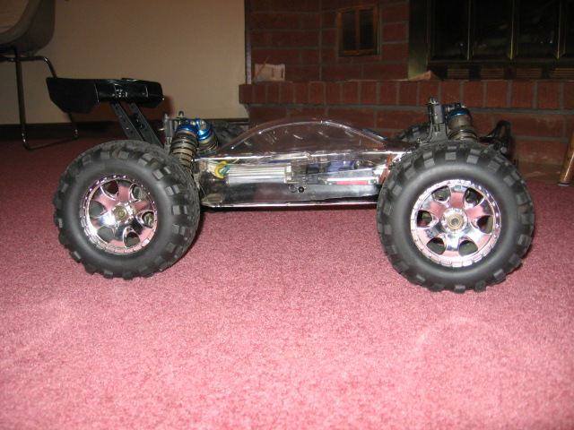

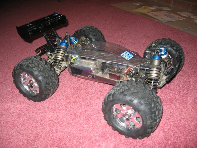

Looks nice.

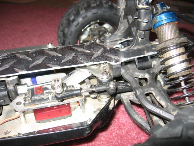

You should also upgrade the steering link and replace it with a jato turnbuckle. And if you haven't already, also replace the bushings in the steering assembly with bearings. These upgrades take away the steering slop.
I'm having an e-muggy chassis made with no holes in it to let any dirt through. Should also eliminate chassis flex.
