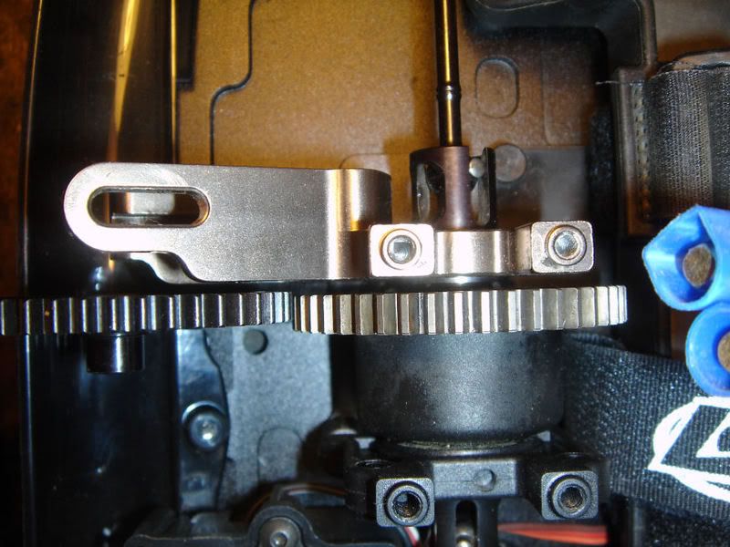

Well I got the buggy out a few times to the track and I have been very pleased with the quality/durabilty of the Losi conversion. One thing that I am still having trouble with is motor temps, I again tried several pinions with my Eagle Tree hooked up and the lowest temps I got after 10 mins was 150 degrees which seemed on the warm side. So I decided to use a 47T spur which is closer to the stock buggy gearing (48T), instead of the Losi conversions 45T spur. This should give me a few more gearing options. I bascially had to open the hole in the plastic spacer a little bit and grind off a little area under the spacer (there is already a milled out area under the plastic spacer).
Using a Robinson Racing wide gear which is easier on the pinions because they are slighty wider and have more surface area.
Hard to see, but I opened up the hole in the plastic spacer and milled out a small area under the spacer.
Losi 2.0 8ight-E / Losi 2.0 8ight-E/T / jammin SCTRC10 / Slash 4x4 PE
  (#71)
Electric Dave
03.04.2009, 08:56 AM
Going back to a steel spur?
Do you really think 2 teeth will make that big a difference?
Time will tell I suppose.
Dave, it's probably just me but I stripped the Losi plastic spur after about 5 packs. So yeah I think I will be going back to steel, the Losi spur cost as much as a hardened pinion and when using the Robinson wide spur the steel pinions last a long time. Without a slipper the spur takes a beating, both during acceleration, braking and I just had too many failures using the plastic spur which could cause a DNF during a race. Also, the 47T spur will allow me to use slightly bigger pinions which will last longer (more surface area/teeth).
