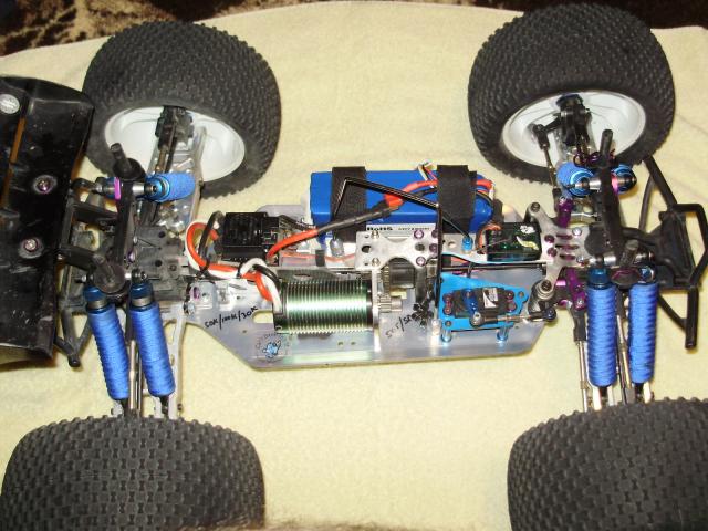

For what it's worth , In my Lightning Stadium Pro Basher truck I'm running M.M.M.2200 w/4s&5s with diff fluids as follows; 30K-F 100K-C 50K-R and it's a friggin' great bashing set up.
My 2cents
