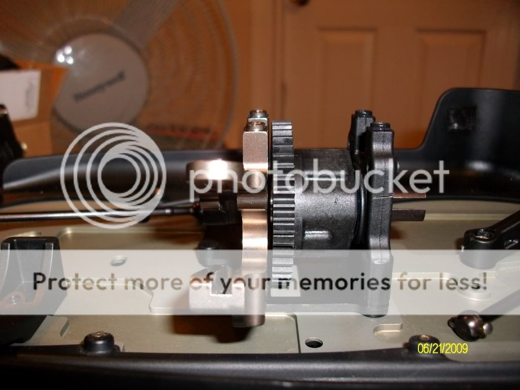

I just use the kyosho 46t plastic spur. With the Losi mount, there is no play. With the rcm mount, there is a little bit of play that is solved with a 8x12x.5mm shim between the bearing and the spur.
