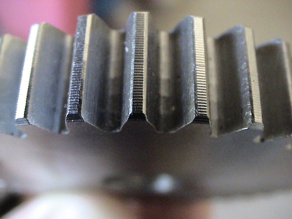

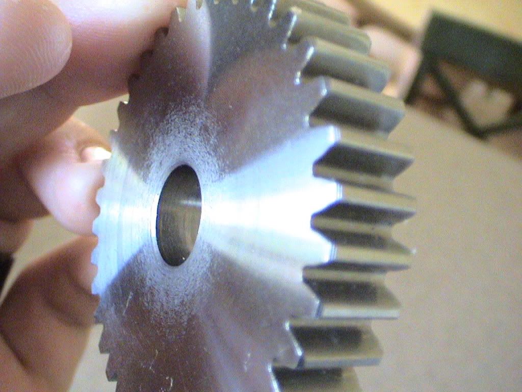

so the 36t gear that i got is the same diameter as the stock bevel gear and fits perfect. however you could go larger for sure and get that 40t gear by just flipping the center diff mount upside down. this gives you another 3/8" of room off the chassis. you could maybe even make a 44t gear fit. i think the 40t is gonna be the ideal gear but we'll see how this one does.
dont know about drilling holes yet. the gear also needs to be milled out a bit. it is too thick and needs to have the center section made skinnier in order to mount up right. i hope they can pull it off otherwise its back to the drawing board and will just have to have SDP make a custom one.

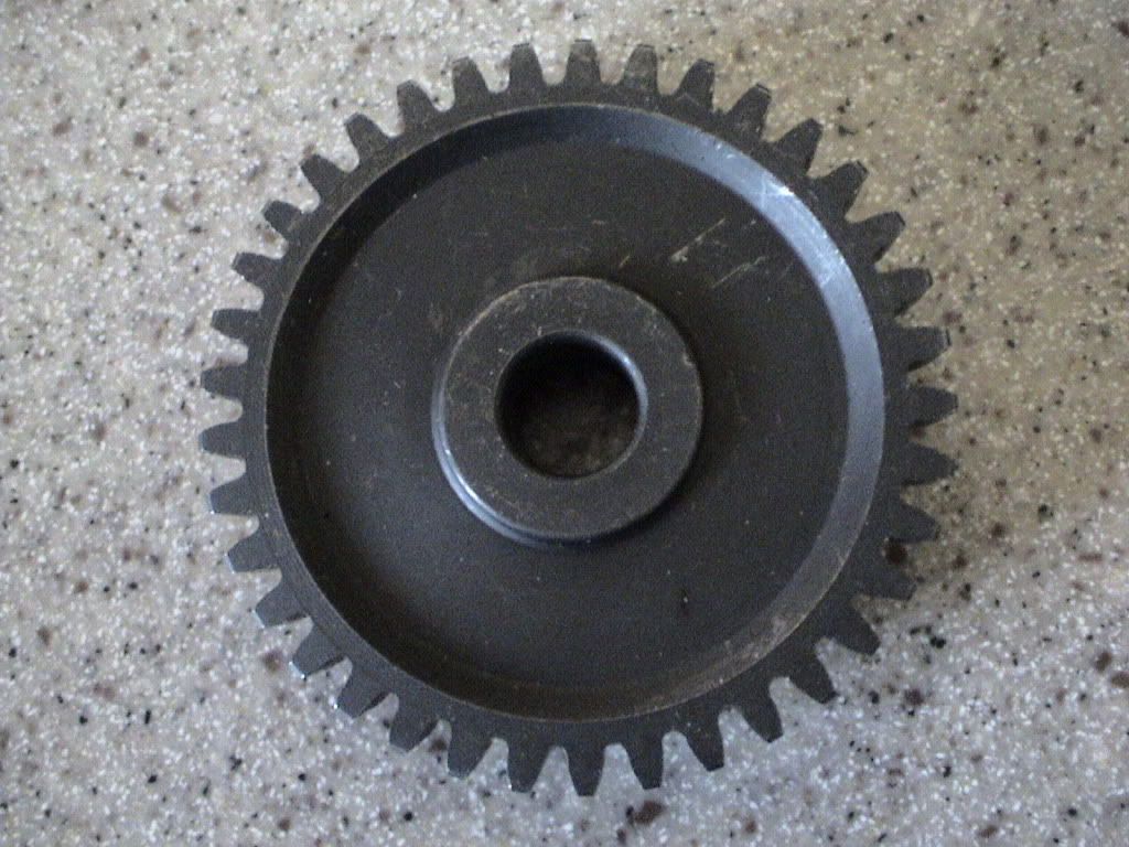

here is my 37t spur that i am gonna have made to fit
Photobucket
here are some pics of the SDP gear.
Photobucket
Photobucket

That gear is big. Seems like the whole thing could be thinned out,maybe 1/8, and then a smaller section out of the middle "counter sunk" where it botls to the locker.
Is that gear hardened?
  (#143)
07.15.2009, 03:11 PM
The sdp gear will not be hardened. May be the only issue with it, depending on what pinion gear you plan to run. I would leave it full thickness, or only mill it down to match the teeth width on the rcm mod 1.5 pinions.

07.15.2009, 03:22 PM
i am just gonna do like what you said Kaz and mill out the central area of the gear so that it sheds some weight and mounts up properly to the drive shaft but still is very wide. it is not hardened but i have to tell you it seems way stronger/harder than the gears that i have that are hardened. plus, there is a company here local that i could have harden it if needed but i dont think this gear is gonna have any issues. and acutually the rcm pinion is wider than this. the sdp gear is 10mm wide. i havent measure the rcm pinion but i would guess it is about 14mm wide.

You realy need to get it hardened... its very easy to do if you have blowtorch, just heat it untill it starts to go from red to white then drop it in cold water and thats it.
You might want that spur last longer than pinion, so it should be hardened.
I have hardened HotRacing pinions and those last just long as other hardened.

about the hardening, take it to the local shop to get it done properly, it's not that easy. they should do that for a few bucks, regarding how expensive this hobby is, its worth it. go with the pro.
