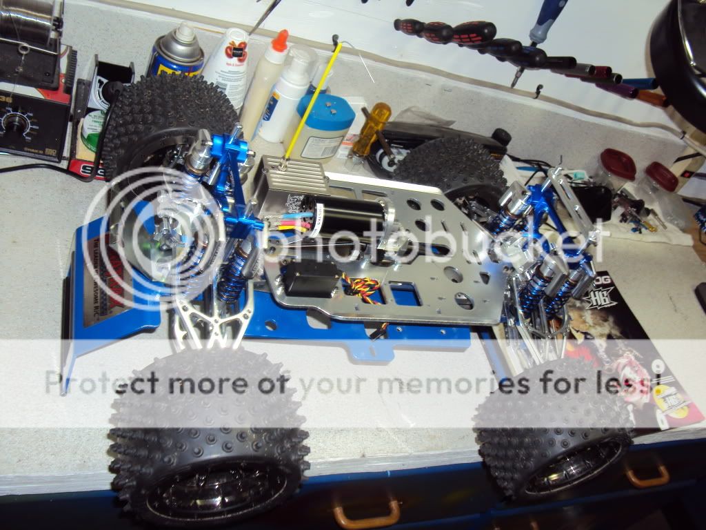

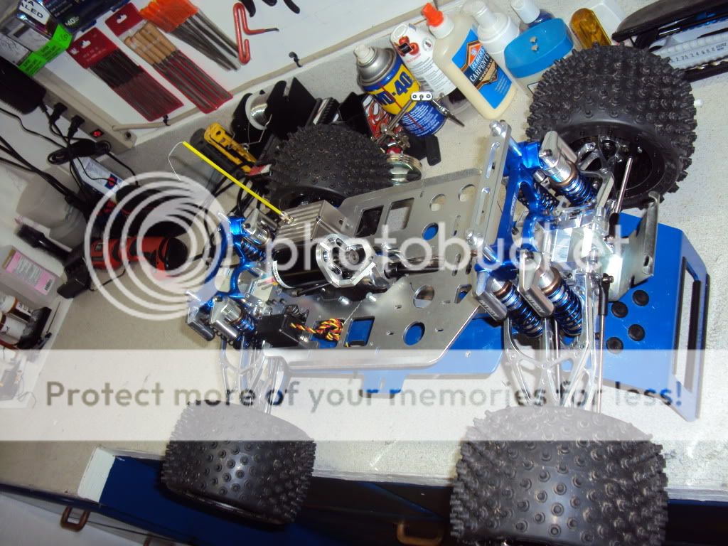

OK so just before Christmas Harold surprized me with a gift of joy. He had received a special kit from RCsoutions because he wanted the suspension, roll cage, and a few other items, but did not need the chassis, because it was an extended TMaxx setup. Anyway the chassis is a stamped 1/4" aluminum plate that is about 1/2" longer and an inch wider than the RCM EXT 3906 chassis. It also came in with the specail steel skids and aluminum braces to fit the rig. Well I was not sure what to do with it at first, but just knew that something would come to mind at some point. Low and behold MonsterMike came out with the universal center diff mount and Vuola. I will attempt to post up a few pics. The rest of the truck is made up of stuff I just had hanging around the shop not being used. So yes even some old Integy stuff is on there right now, because my UE Supershocks have not arrived just yet, and I do not have any other shock towers on hand. It does have UE CVD's, RCM hybrid diffs with hardened HPI diff gears, and a 1521 Neu motor. OH and a full set of UE Extended suspension arms that I just got in from one of our members for like $100. I will end up putting in an RX8 when I have the cash to do so, but I am leaving for a funeral in California this weekend. SO that has to wait.

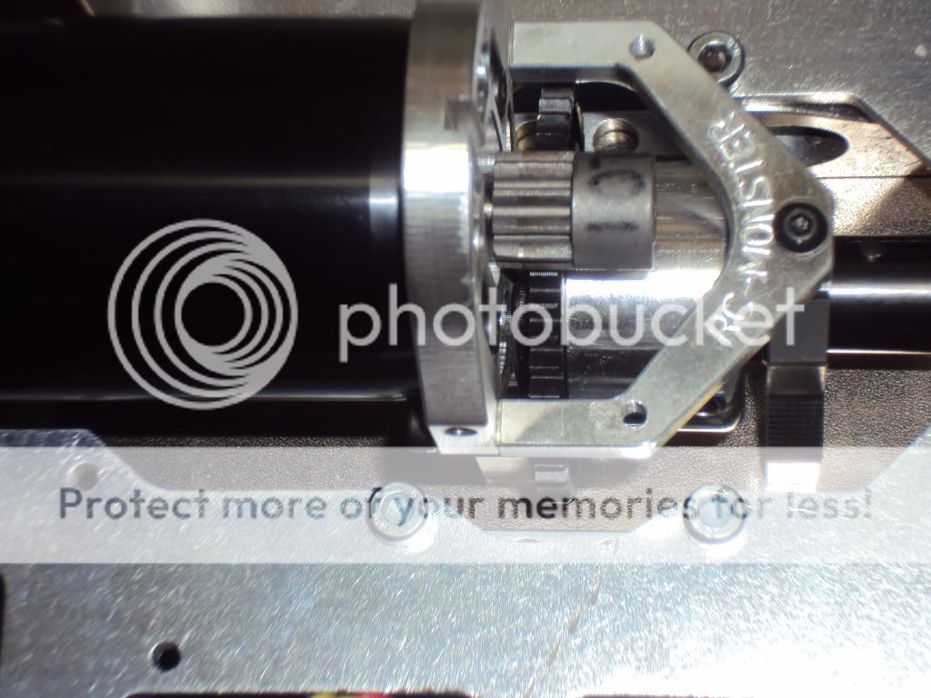

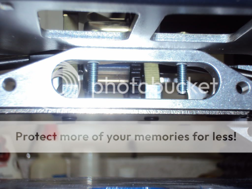

So I had to think about how exactly I wanted to mount the new RCM center diff unit and keep everything structurally sound, while at the same time giving me enough room to take full advantage of the spur gear options I have on hand. I have from 44T up to 52T steel spur gears, and eventually I would like to try out Mikes Slipperential. So for the moment I have mounted it directly onto the titanium center skid, and managed to shave out some space on either side of the spur gear to make some room for whatever spur I want to put into it. I have some 4mm hardware coming in from BoltDepot.com so I can upgrade the mounting screws making the whole uint a bit more rigid. Plus I will rase the mount up about 1/4" to give more bottom clearance for the various sized spur gears. I believe that Mike said it would hold up to a 50T or 52T spur gear.
The other thing that I did was tap out the outer four transmission hole in the center braces to 4mm as well and added clamping screws to the mix for more strength keeping the whole setup stable and eliminating any weak spots in the chassis configuration. I will change out those screws with 12.9 grade 4mm screws and put nyloc nuts on the bottom side for even more holding power. All in all this setup is a very solid configuration and it rolls very easily. I was lucky enough to have two perfect sized center drivesafts for the driveline and it is nice and tight with cushioning in the cups, but not at all restrictive.

Jerryy... your stepping up your GAME... WOW.. looking good big guy.. NICE..

Nice bling man. That thing is huge.

Looking very nice. I like that receiver box. looks nice on the rig.

Anyway, mounting your cd on the titanium center skid will work. Personally, I'd suggest using a thicker iece of aluminum for strength and rigidity.

Thanks guys. This is the first time I have ever really had to do any mods for putting one of these together, but it really was not to much trouble at all. The Titanium skid is actually pretty stiff. In fact it is more like having a steel plate under there. Once I make the aluminum plate to go under it to raise the mount 1/4" it will be even stronger. Yea the Integy shocks were all I had at the momnent, so they will have to do until the Supershocks arrive.
