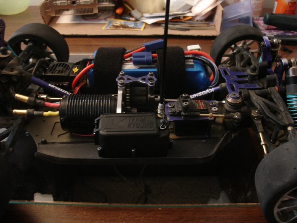

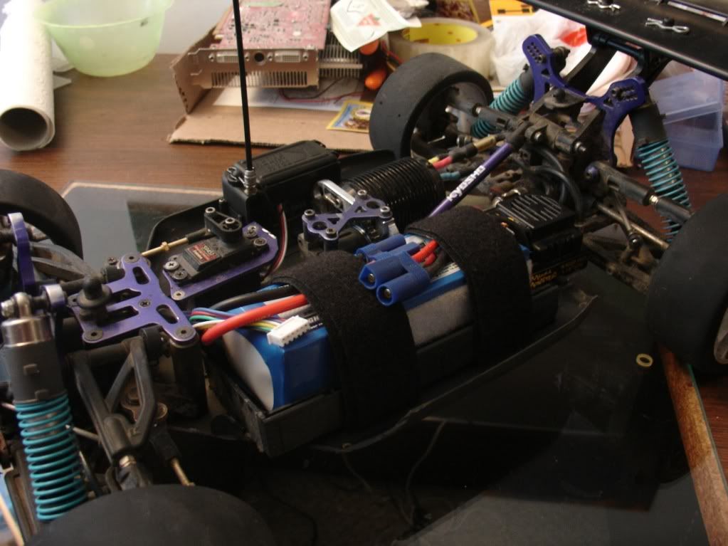

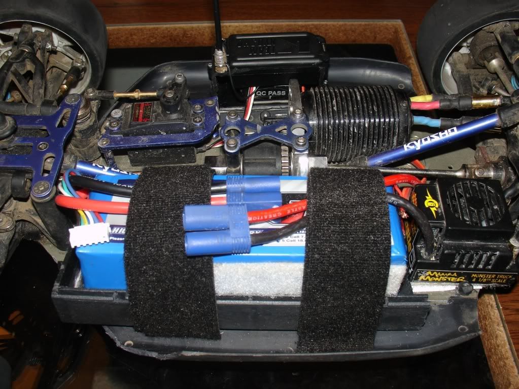

Finally had time to fully finish my E-buggy conversion.
How it stands right now, weighing at 7.8 pounds with everything but body. I think it will be even lighter with offroad tires, the slicks that are on it now seem to weigh a ton compared to regular bowties, crimes ect....
Specs: NEU 1512 2.5D 2050KV geared at 13, but will go up to a 14-15 soon, its under-geared
Controlled by MMM running on 5S 5000mah
Custom Battery tray made by me, custom radio box also modified by me.
Weight Distribution is 3.7xxlbs front and 4.0xx rear
And of-course last but not least Mike's Kyosho mount

It is my first BL toy. I've been running nitro for a couple years now, and I'm almost fully switched to brushless.
It really handles well, I was keeping up with a mbx-6 with 2650 MMM on 4s.
I'm switching to 4s for the sake of the motor and to keep the speed down for track use.

Those slicks are garbage.... all I could do with those is drift.
If you wan serious onroad performance use the losi grp tires
Far right in the pic
