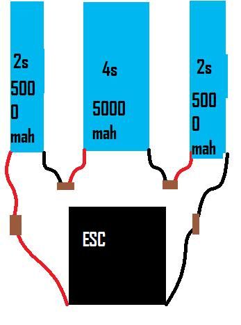

Ok a few things... need a little advice and confirmation...
As you know iam going to try an 8s configuration... to keep things balanced, in the truck,
I am going to buy 2x2s and one 4s lipo. And place the 4s in the centre of the chassis and the 2x2s either side in battery boxes by kershaw.... I will be using bullets and was wondering if it is ok to connect them this way...

The wiring diagram you posted is correct, as it keeps everything in series. As far as the ESC, if it doesn't have a fan, add one. There have been other users here using the castle (and other manufacturers) airplane esc's in ground vehicles before. Sometimes with a fan, sometimes not

When you do your calculations it is better to use ~3.7V for the cell voltages. Under load they won't be holding at 4.2V/cell even when fully charged.
