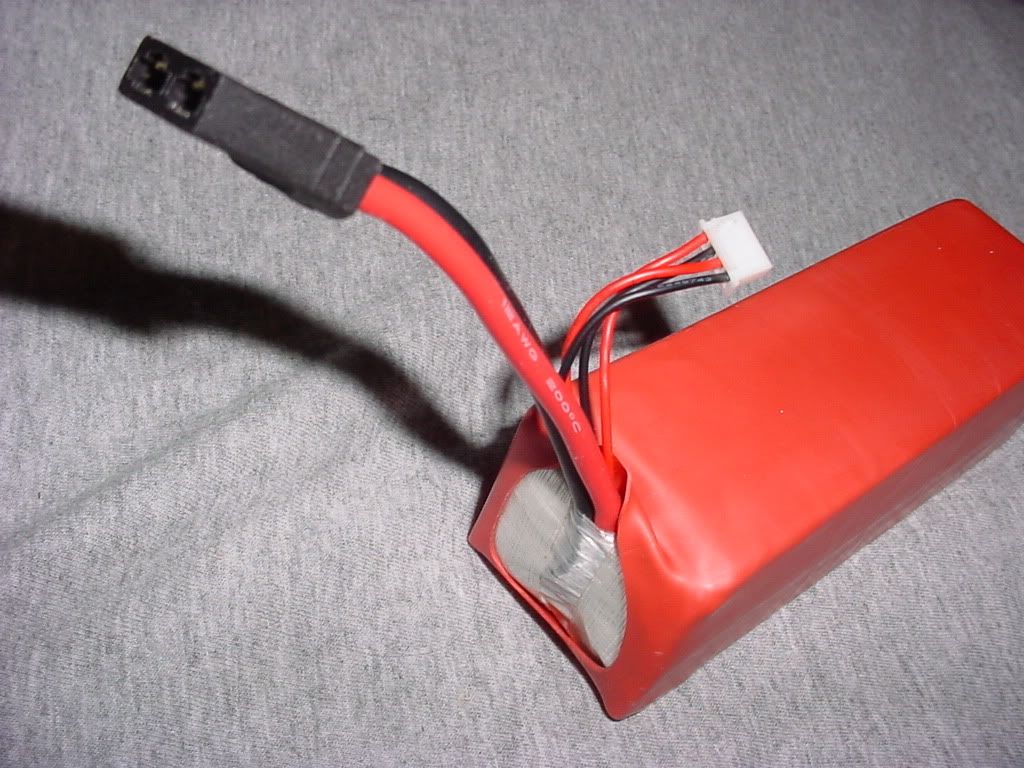

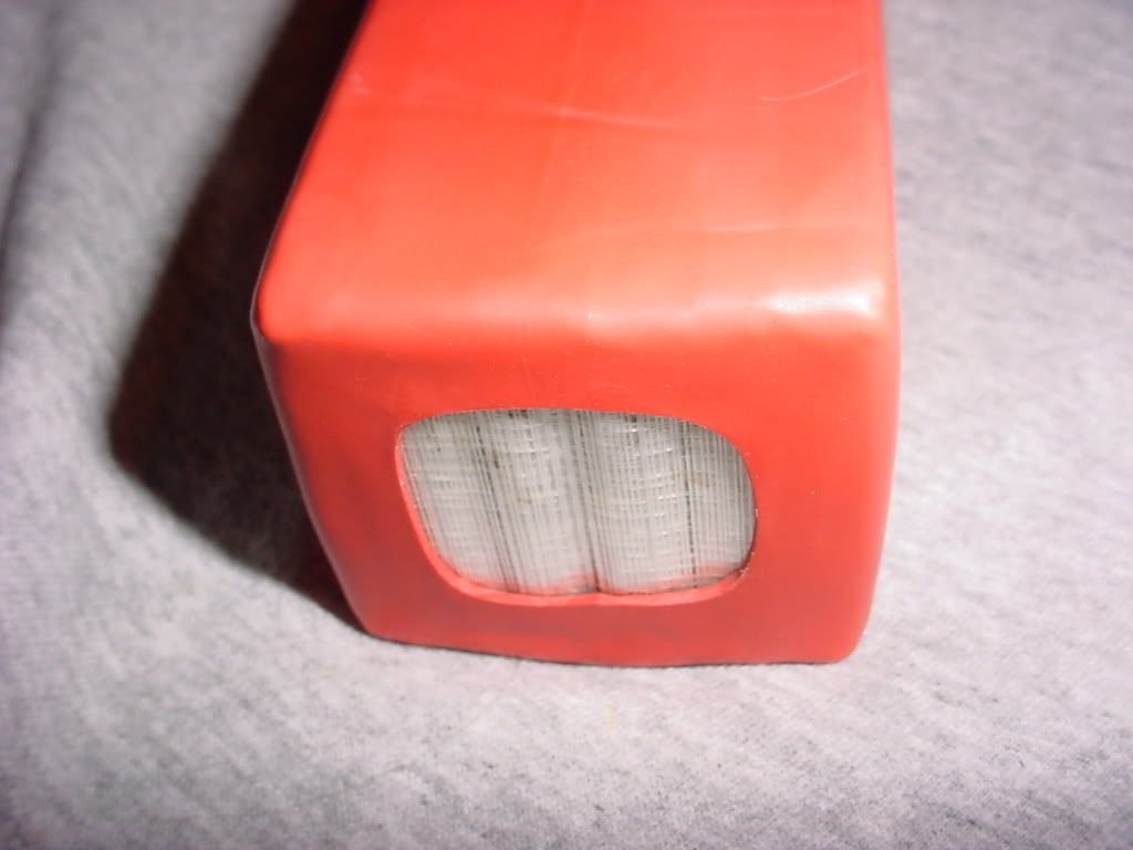

Well, I bought a meter of the Red 50mm. btw, 50mm is the smallest it will shrink to. So not a very accurate description. Laid flat, the "50mm" is actually 80mm across.
BUT...............
I love this stuff!
Recently, I bought a lightly used True RC 15C 8000mah 3S pack, that was in need of a new power lead and new balance lead.
After some fixing up, I was disappointed that this new shrink was just a little too small to slide over it.
Determined, I slipped a length of this strink over the handles of two claw hammers and stretched it, until it would fit. LOL
I LOVE the final results! This is like installing Rubber Armor! Much thicker than conventional shrink!
Check out how it conforms to the pack. Good Protection.

looks great Sikes, dam near professional !
I've used the 50mm myself for reshinking some Zippys and I to was impressed with the thickness and ease of use of the HC shrink.
