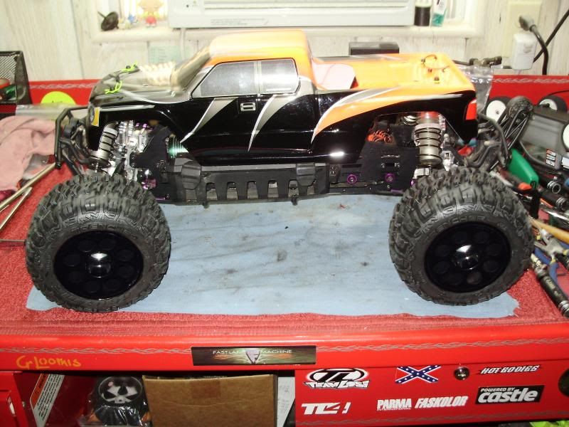

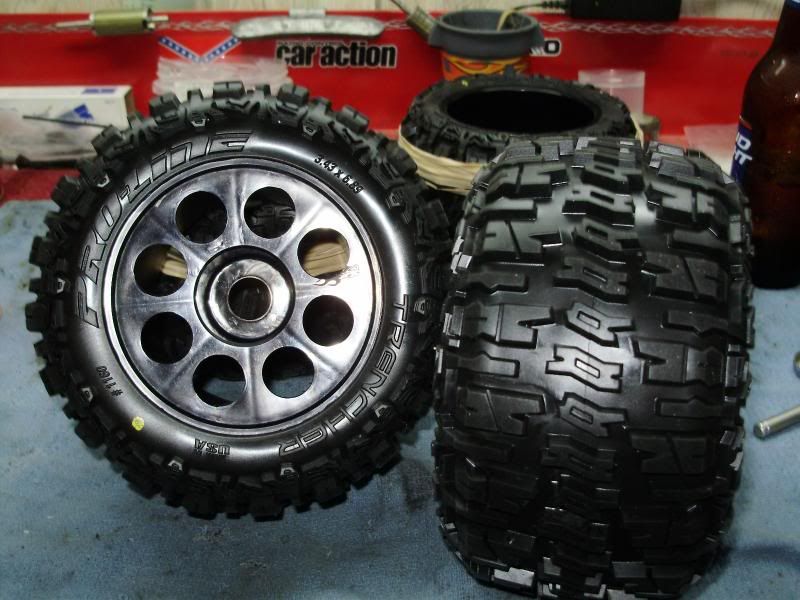

Finially finished the entire assembly, Had insomnia last night and was balanceing tires at 4am. I haven't ben feeling the greatest the last couple days so I may not test until Monday or Tuesday ?
I installed the ESC(pulled red wire) , 1200mah 2s ThunderPower RX battery and RX on battery tray, lots of room for electronics there.
Mounted and balanced PL Trenchers on 23mm 40series 1/2" offset Dyed PL Velocitys
The XL body doesn't fit to bad, Think the next thing I may consider makeing will be a roll cage for the cab and tie into the F&R shock towers ? A roll over w/this Heavy assed MoFo will destroy some Polycarbonate.
Time to look for some 1/4" 7075 solid rod and fire up my aluminum welder.
Very nice build there Bondo! That thing's gonna kick butt!
What's that rotor I see in picture #1?
Nice job fitting the motor in. Do you think it's possible to squeeze the 1717 into an E Revo? I'm thinking about taking a look at that when my order comes in.

Bondo, I just realized you drilled those wheels out. Aren't you worried about them breaking under such a heavy vehicle?
Thank You Sikes
Rotor, the 6mm shaft that I turned down from the 1717
1717 in a Erevo, It's possible but thats asking a lot. The motor is nearly 2lbs and hangin off a questionable qaulity aluminum plate and a plastic trans case I can't see it working for long if it fits ?
If you try, get the heli version w/the flat sides.
MB4;
Not worried in the least, The structural webbing/braces are still intact.
