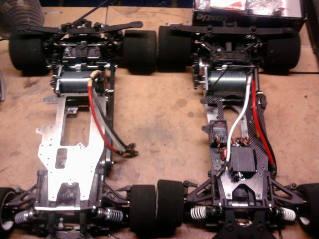

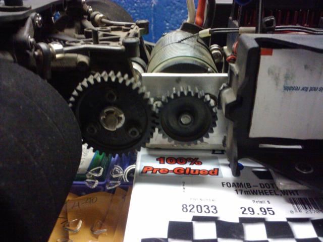

this was some rush work when i first built the cars but now i have cnc mill access the motor mount will be replaced this week for the up and coming season. the other car is a XR80 he's now running 8s with mech brake . i have a small crack from a collision that happend last year in my front bulk so... since i don't have my bearings done yet i could post the process i use here.

Also on the brakes im not really sure how other people feel about the current setup for these cars, i watched a few races with these puppy's and it seems they use the brakes to help rotate the car in the corners and i have no need for this feature so i locked the fronts to help control braking from higher speeds. so it may not be for everyone but it sure tames the car to be driven like a normal car. just my few marbles

it's really hard to say, it all hinges on the motor you use we chose 2200kv's due to the deep gearing and speed we wanted the speedpasion mount will not work with the 2200kv so i chose to make my own mount. the revo mount from rc-monster looks good for the 2650 also and would fit a few others i just was in a rush to have what i wanted and made a few crude dude mounts if you use mech brakes you will find things a even tighter fit
