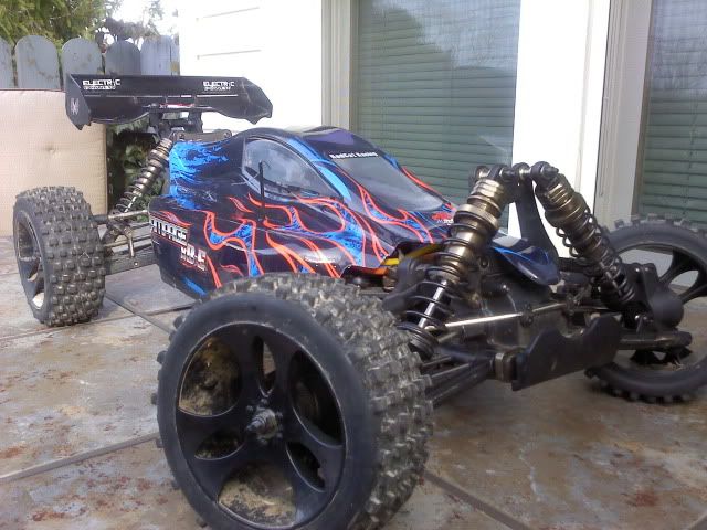

I love mine, so much in fact I sold all of my other gassers( 2-Bajas, Rampage MT, and even a Rampage XB). On just 6s with the CC 1717 motor and stock Hobbywing 150amp esc it is WAY faster than any gasoline RC I have ever owned. Ive had some pretty potent gasoline motors, none hold a candle to brushless power. I have about 5 hours of runtime on my car and only managed to break the wing. Granted it was 35degrees outside at the time, so it is to be expected. Its the best largescale I have ever owned, period.
Here is a little eye candy for ya:

The stock mount works but the mounting screws on the 1717 are a little bigger than the stock motor. I just drilled them out and screwed it all back together. The motors width makes it a tight fit, but it does fit.
