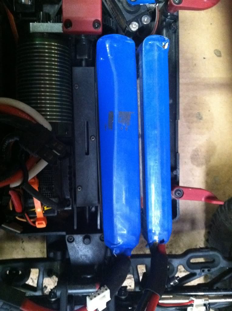

I managed to fit my Turnigy 5S 5000mAh 30C lipo in there with a small mod of the top deck. I tried to fit the 6S 5000mAh 40C pack in there but it's too tight. If I move the pack on it's side and change the wires from from 8awg to 10awg then it might fit too. I'll run it on 5S and then determine if 6S is even necessary. Can't wait to run this beast. I was also very impressed with the ACE radio. Definitely one of the best RTR radios that I have seen to date.

Glad to hear your 5s pack fit in there. I was looking for a single 5s that would fit. I have run it with my Hyperion 2 and 3S 45c packs combined to make 5s but I had to strap them to the top of the cover. They are very long batteries. I will order the same turnigy pack as you.
4S is nice alone. 5s is very powerful and fast. I have no need for 6S.

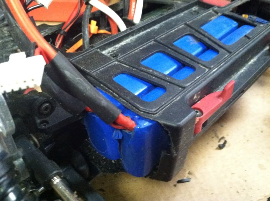

Hey Chainsaw, I haven't had the chance to run the MT4 just yet. Always one thing or another that gets in the way. Anyway I had some time to take pics of the battery fitment and what I had to do to the top deck in order to make it fit. Hope they are clear enough. Sorry but taking photos isn't something I am good at.
It almost looks like it isn't going to fit at this point but somehow it does. LOL
You can see on the left how I have opened up the hole for the wires. I did a really rough job with a hobby knife but will clean it up with a Dremel later on and make it look all nice and round.
And here it is with the top deck on. It is a bit of a tight fit but I prefer it like that then have the lipo bouncing around in the tray.
Close up of the wires coming through the top deck.
Now while the lipos fits I think it would be better to remove this bit here. I am not sure why it is there but I would rather not have it there. If the lipo slides back in the compartment it could get damaged by this thing. I will remove it with a dremel before I start running the truck.

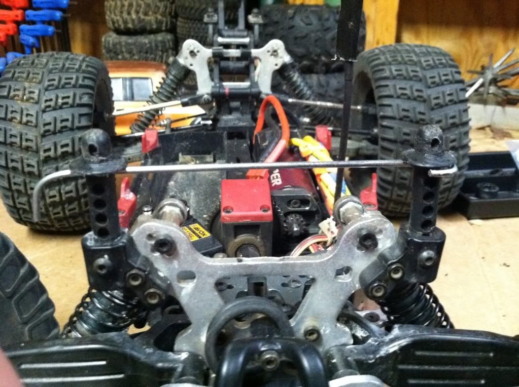

I just lowered my body down as low as it can go.....but some sort of support in the center is a good idea. maybe use a foam block of some sort with strong doublesided tape to the underside of the body? I also gorilla tape the the weak parts of underside of all my bodies for extra strength.
I put this metal rod through holes I drilled in the front body posts. I had the posts smash through my proline F-650 body after many upside down landings. this will prevent them from going through again
thanks for the pictures of the battery and how it fits.

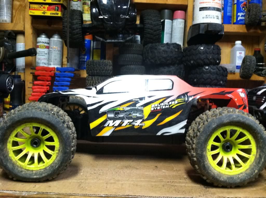

Got my Hyperion 5000mah 45c 5s set up to fit nice and snug.
This bug body is my favorite that I have for mt truck

Looks good. I also like the bug bodies on MTs. I used to have one on my 2.5 Revo and was probably my favorite body. Is that the short or long version you used there? Wondering which one would fit better.

Yeah I had this bug body on my E-Revo so it's the long one......my e-revo just sits and doesnt get used anymore!!!
definitely my favorite body.... I can't wait to wreck it so I can paint up a new one.

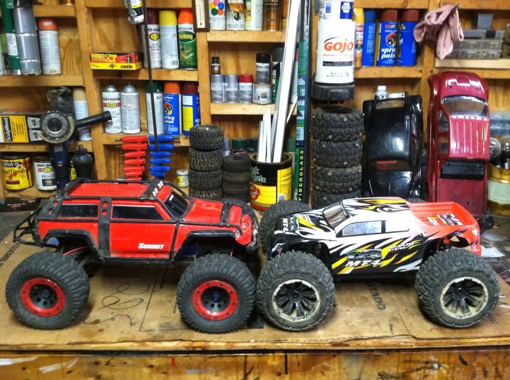

coolhandcountry
coolhandcountry's Avatar
Posts: 6,741
Location: VA in the US
12.14.2011, 02:55 PM
It looks big.
How tall are the tires?
What is the wheel base on it?

Chainsaw10
Posts: 38
Join Date: Oct 2011
12.14.2011, 03:05 PM
It's about the size of a summit. Tires are same diameter as proline trenchers. Don't know the measurement off the top oft head. I'll check for ya later
