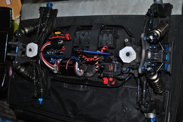

yeah photos are nice huh? sorry guys had to get to a pc, iphone wont do it. 1400kv on 2650 6s 40c 3330-3400 rtr depending on the tires. use about 600-700 mah on a medium size indoor clay track. got some 6s 3600 30c's for long outdoor mains with the noisemakers. enjoy!
ps. towers and arms are the new worlds stuff. had it for a few months and really like the responsiveness it added to the car.

Looks nice. Wow, that front shock tower is beefy, about 4 mm? What kind of setup changes did you make? If that is a CFRP chassis, you might have raised the CF quite a bit, which increases roll.
You used only 700 mAh for a 5 min qualifier? Or 700 mAh per minute?
I realized the biggest LiPos that fit my trays hold about 2600 mAh. Yesterday, I got two Fullymax 3S 2600 mAh 35C really cheap (48 USD per pack, half as much as my Kokam 2400). I haven't mounted them, but looking forward to not having to wait 30 min between runs.
Regards
Thomas
slimthelineman
slimthelineman's Avatar
Posts: 608
Join Date: Jul 2008
Location: IBEW
06.04.2011, 07:40 PM
Front tower is 5mm and it uses roughly 700mah in a five minute race on a medium size indoor track with a 1400kv on 6s. Geared for about 38-40 mph. Roll center has changed slightly but more than anything the worlds geometry was the biggest change. Had to stiffen the shocks a bit and some other fine tuning for my driving style but mostly learn how to drive the new car with all the turn in. It's a tad looser than my rear battery b setup but I will probably move the pack to the rear and see how it does. As it is now it has tons of steering but not as stable or as much corner speed as with the pack in the rear.
