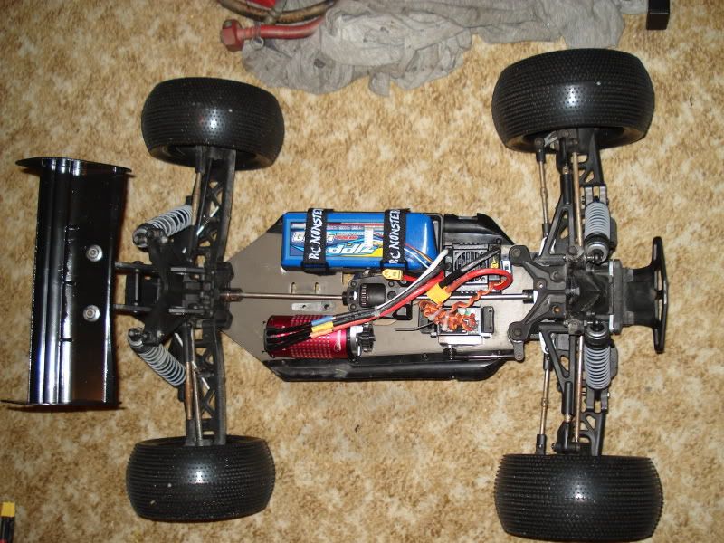

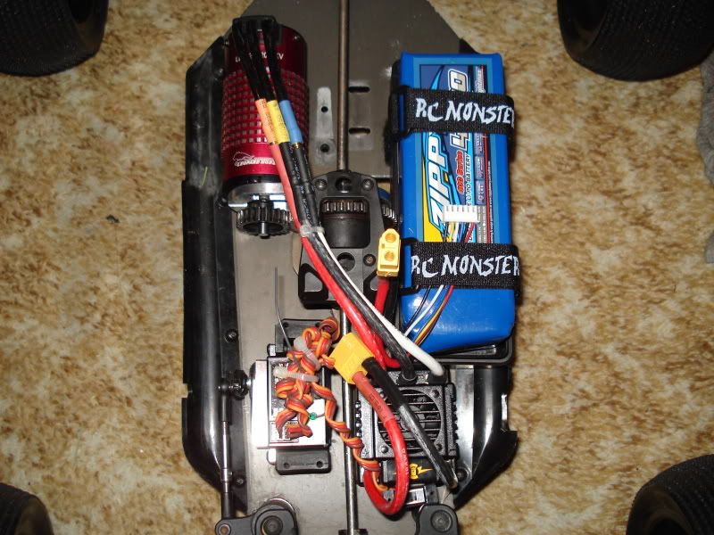

Hi all I just thought I would throw this up on here
My First Conversion from Nitro to Brushless
Started with a X1-crt that had been sitting in a rubbish Bag for about three years reason can't stand Nitro fumes any more which makes me sick.
Current Config
Castle Creations Mamba Combo (2200kV)
Turnigy 5800mAh 4s 25C/35C Lipo's
Custom Battery tray & ESC Mount
Planned Upgrades
Torsen Spider Diffs Front and Rear
Super Torsen Center Diff 48tooth Spur (To stop tyres from ballooning)
Rc-Monster X2/x1 cr Motor Mount to lower the centre diff.
First race meet this weekend hope she Holds together

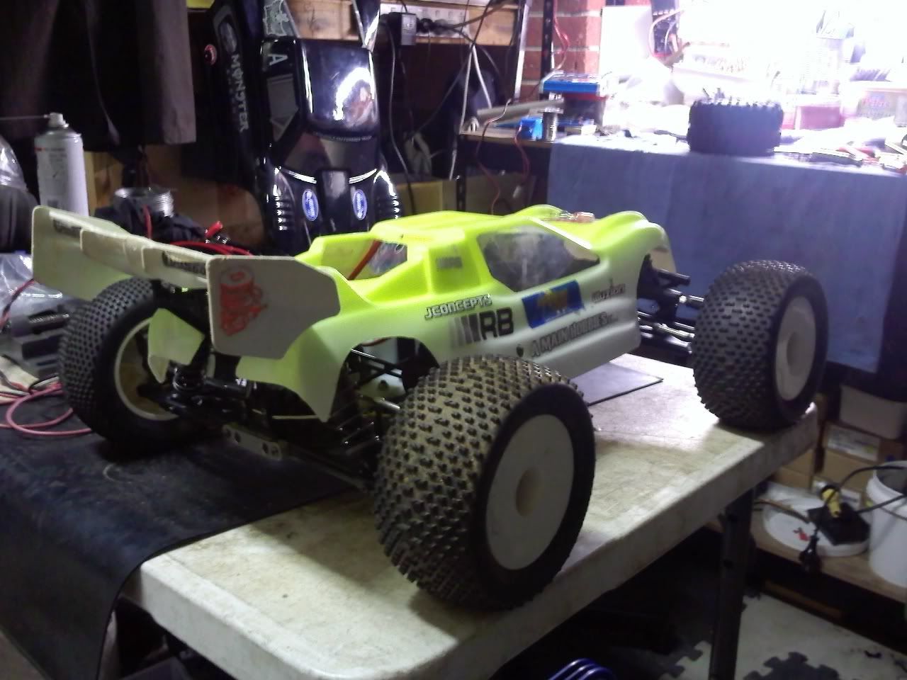

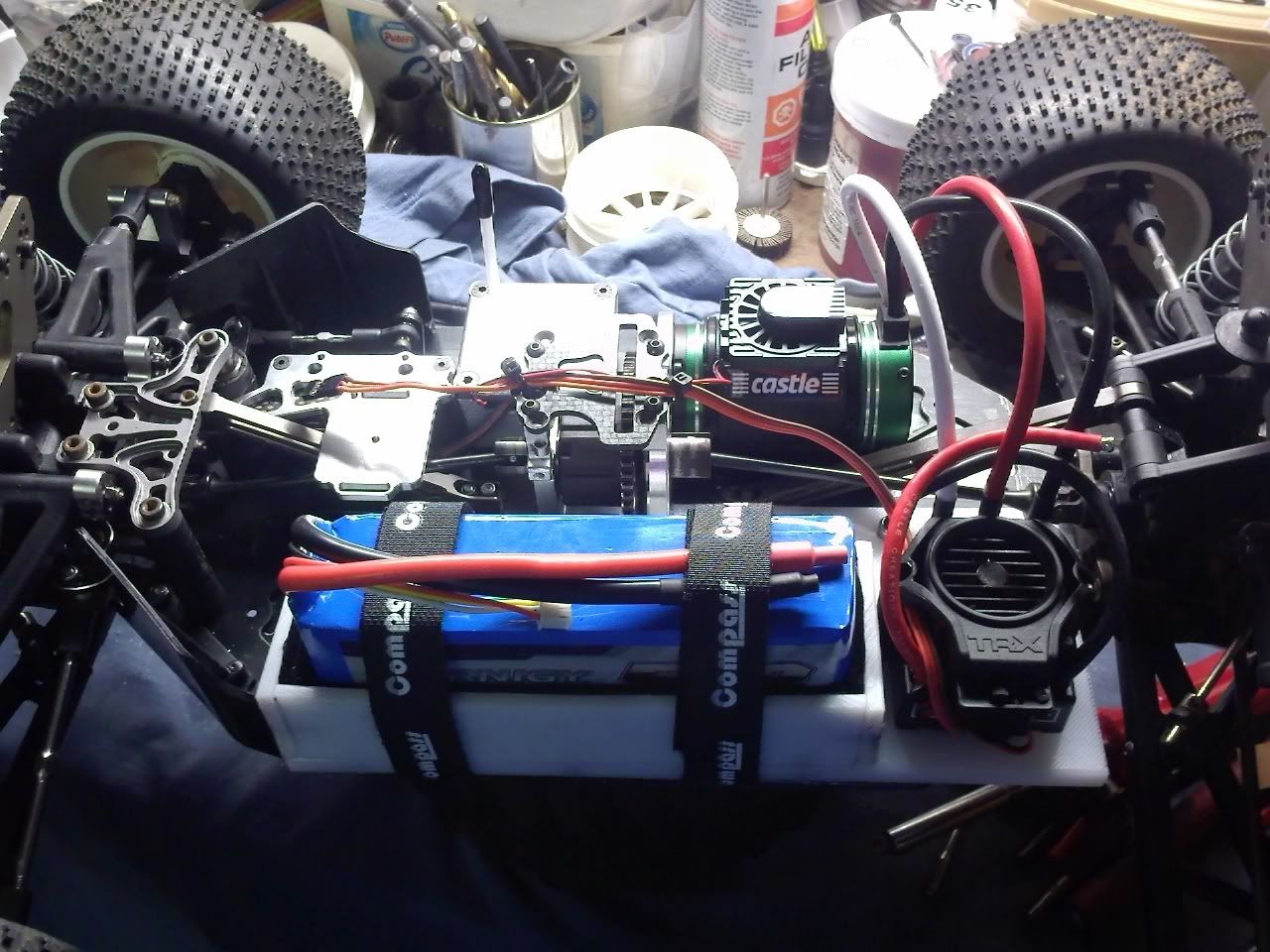

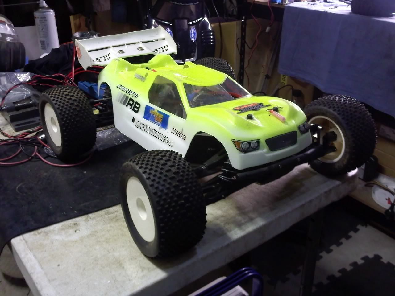

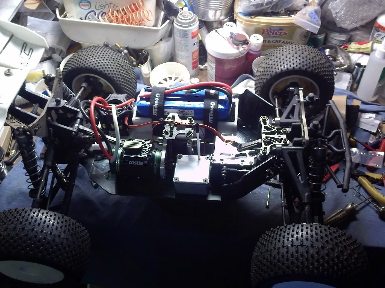

I just completed another mates truggy conversion. Hyper ST.
This is the first time I have seen under the shell of Jason's X2. The last time I saw it was when it was sitting on his coffin at the funeral.
Enjoy the two pics I have of the Hyper.
