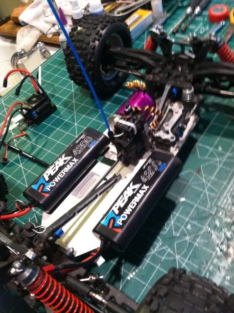

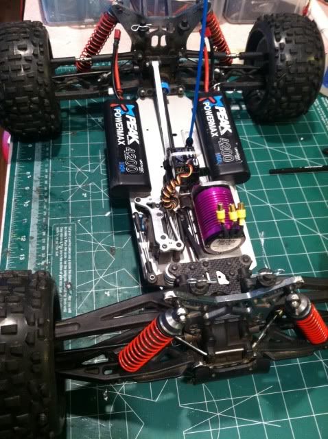

I've had the truggy for a little while, I bought it as a kit and converted it right away to electric. I ran it for quite some time with a hacker 16xl on 5s lipo, it was great until I blew the rotor apart (wasnt wrapped in kevlar or any material, the magnets just came off. so I pulled the motor out and have been running it with my hacker 13L, which is about 1800kv while the 16xl was 1200kv. The big difference is the length of the can and the torque at low end. The 13L on 4s powered my a mamba monster cogged a lot! So, I am now running a mamba max pro and its much better, deffinetly keeping that esc in there but I am in the market for a new motor. Thinking either tekin T8 or team epic D8 maybe team orion MR8L, all the motors I'm looking at are 1900-2000kv to run on 4s. Anyways, On to the pics and how it sits
the new spur gear hole since i flipped the center diff around

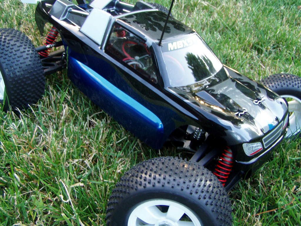

This is a older pic, when I first got it, the nobby pin tires wore down to nothing in about 5-6 battery packs and the body, well it doesnt look as good now

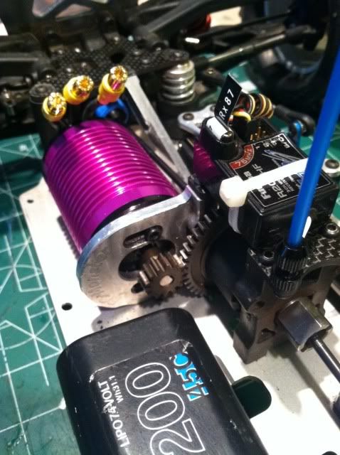

Some specs on it, that will stay the same for a long time. Yes, thats a 75mhz FM (I know, get with the times) at least its a 3pks. mamba max pro, hitec 5955tg steering servo and 5-20-2 diff oil with mugen 400 shock oil.
