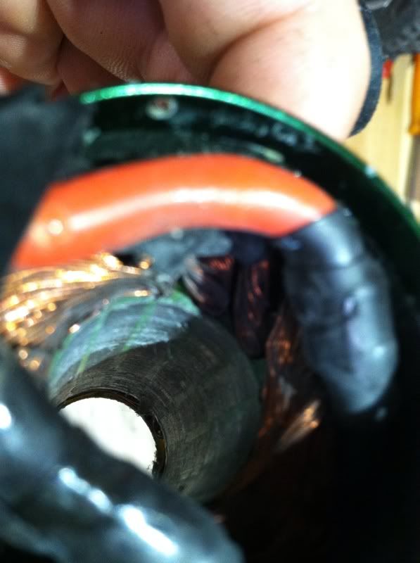

I ran 6s in my buggy as normal... and then this happens!!!!!!! Completely ruined my bashing session and my day!!! Not like i was running ridiculous gearing either. I hope castle can sort me out as I can't use my Losi 8 2.0 anymore :(

Is the inside of the motor damaged, damaged windings of stator? If not, a rebuild kit should do the trick, otherwise whole new motor needed- if it's over 12 months old then it'll be a non-warranty repair fee...

Nope, luckily the windings and the insides look fine. Its just the rotor. 1st guy to have a shattered rotor....Am I unlucky or what :(

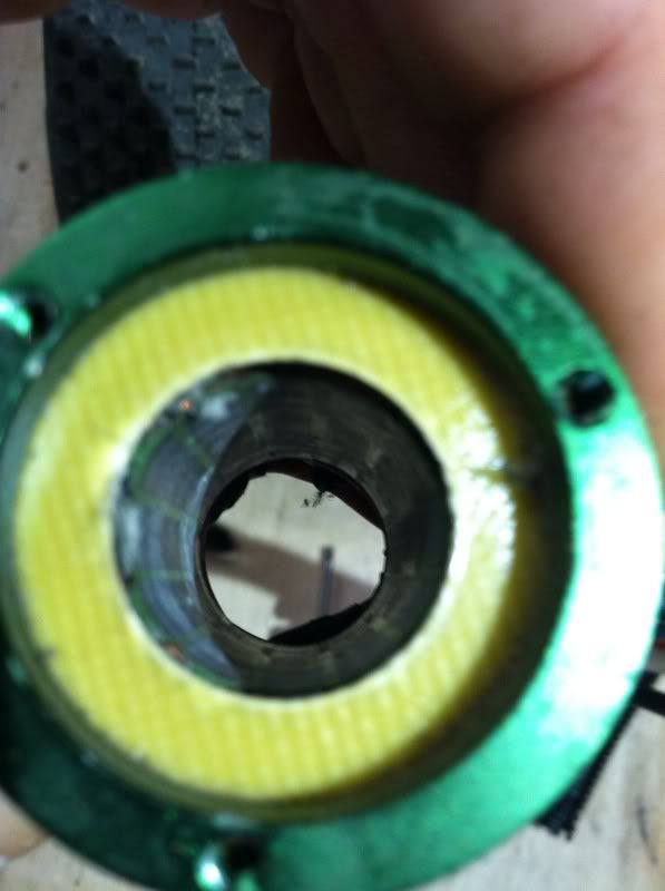

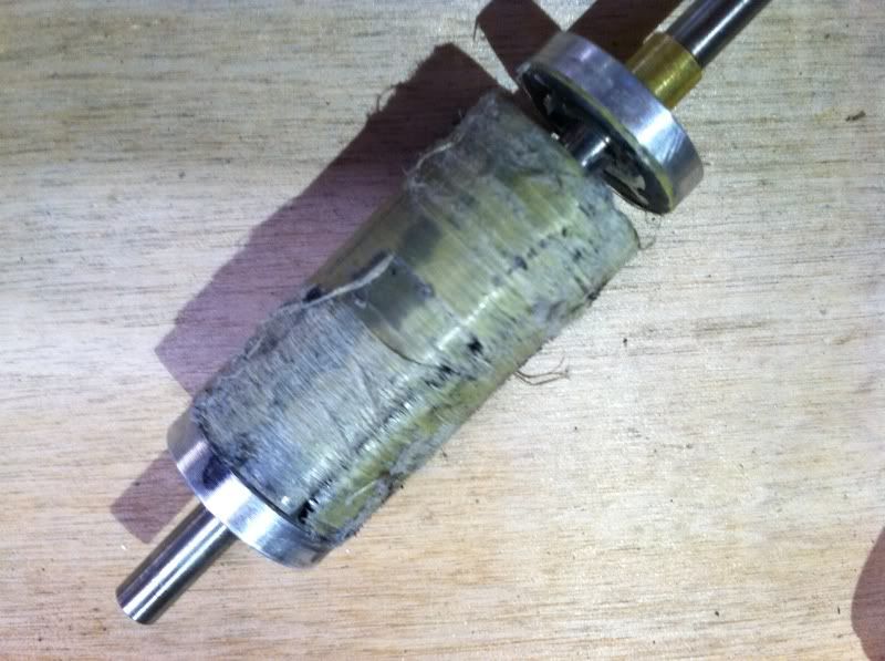

My 2200 motor seized up yesterday...the magnets are just starting to break(not as crazy as the op's). Im definitely not complaining as I have been abusing this motor for over two years now. My question is , will the rebuild kit work for me?
Here's some crappy pics. Hopefully you can see well enough to advise me if I can rebuild. Or just buy a new motor...thanks.
07.16.2012, 12:07 PM
Inside of the motor looks good to me- the magnets would tear it up something nasty and you'd definitely see the scaring if that was the case. Might just wanna use a clean rag or old toothbrush to clean the inside of the motor while it's open, then a new rotor kit should do the trick nicely...

Thanks! Got the rebuild kit and installed it.....good as new. That was simple.
