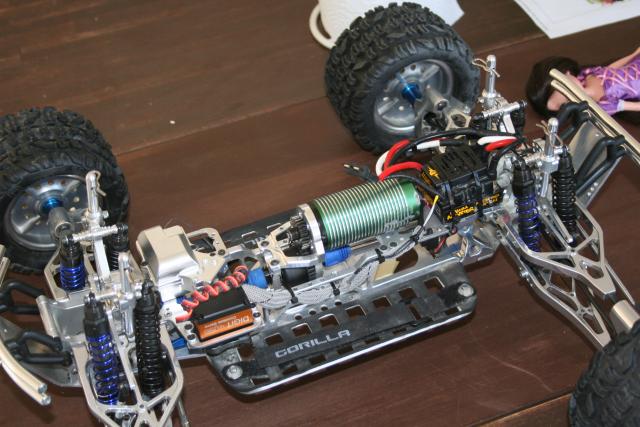

a couple of newer shots
  (#32)
bruun
a couple of newer shots - 08.21.2012, 07:18 AM
UE towers-arms-knuckles-monoblock lower COG
geared 25/43 (running on the warm side)
Ofna cvd`s, TRX 5451R for the rear drive shaft
still building A G-maxx can newer rest

gonna keep the 25/43 gearing for now, changing to a CC 1520 and phaltline tires, to see if it will give a cooler setup-more torque and less tire diameter- the tires on the pictures blew at 93,4 km/h, probably because of front lift/balloning

The truck stands finished with 45/11 tooth gearing, but running on 4s lipo with 6.3" wheels-looking awesome!
