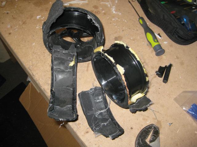

Yeah, that's going to have to wait yet again. I blew the tires off. Belted ofna's suck. There's a guy on youtube that went 129mph this month on GRP's so I just ordered a set of those.
